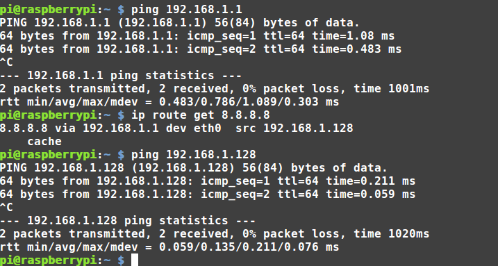

Try pinging 8.8.8.8 again.
success ! It goes out !
pi@raspberrypi:~ $ ping 8.8.8.8
PING 8.8.8.8 (8.8.8.8) 56(84) bytes of data.
64 bytes from 8.8.8.8: icmp_seq=1 ttl=59 time=7.06 ms
64 bytes from 8.8.8.8: icmp_seq=2 ttl=59 time=6.03 ms
64 bytes from 8.8.8.8: icmp_seq=3 ttl=59 time=6.50 ms
64 bytes from 8.8.8.8: icmp_seq=4 ttl=59 time=6.02 ms
^C
--- 8.8.8.8 ping statistics ---
4 packets transmitted, 4 received, 0% packet loss, time 3004ms
rtt min/avg/max/mdev = 6.023/6.408/7.063/0.425 ms

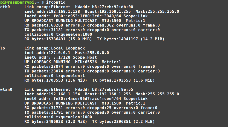

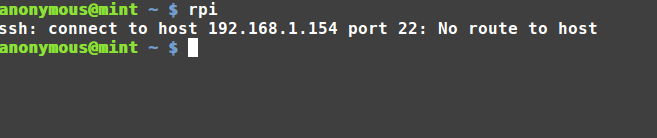

so what should I do next? I want to put my pihole as the dns for the entire network.
EDIT:
I noticed some strange problems with the pihole, I don't know what it is but I'll try and explain it as best as possible.
After a certain amount of time (I don't know when exactly), my internet just stops working for no reason, I have to restart the pihole dns via the web interface, turn on and off my wifi, only then will it work.
Here's the scenario: I go out and do whatever, come back, turn on my phone's wifi, it will connect and say "connected, no internet" I have to restart the pihole dns, turn on and off my wifi again, and then my internet will work. I have no idea what causes this, nothing has changed in the settings, it just happens on and off, and it has been a few times this occurred consistently.
My house has a stable internet connection, so if there's anything going on with the network (getting slow, no response,etc), I'll know it must have something to do with the hardware, in this case, it is the pihole. I'm sure it is.
Any idea what causes this?

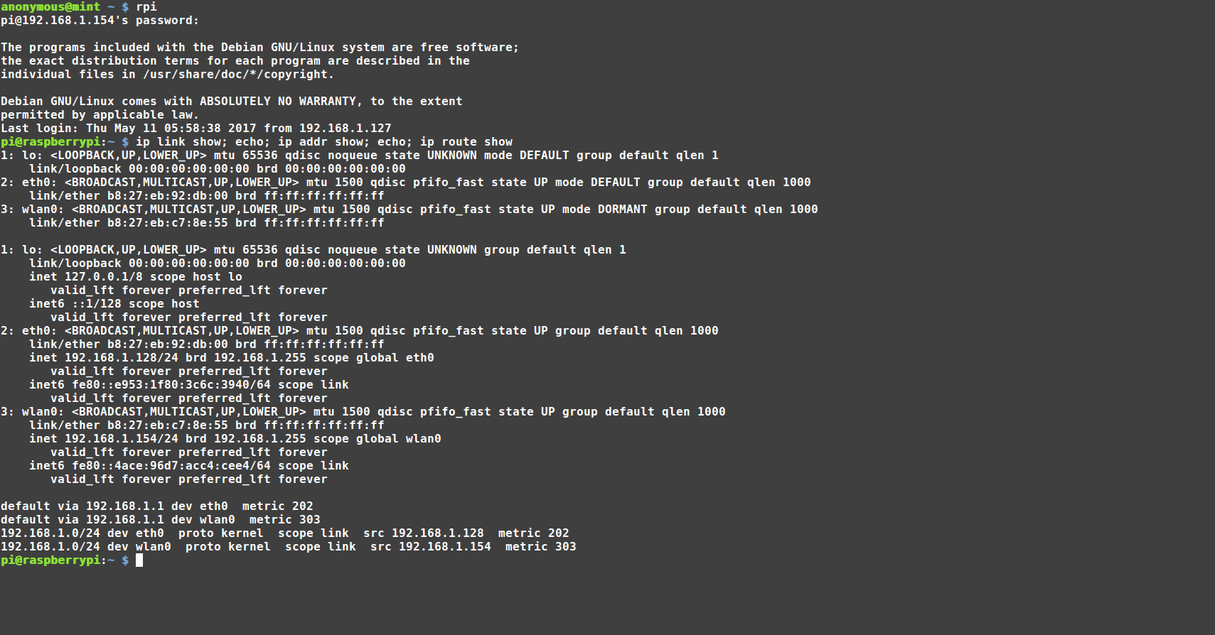

Can you run a new pihole -d
for us and lets check on things.
pihole -d:

::: --= User Action Required =--
::: Try loading a site that you are having trouble with now from a client web browser..
::: (Press CTRL+C to finish logging.)
::: ---= pihole.log
::: Logging will automatically teminate in 60 seconds
^C: 60 seconds left.
::: Finishing debug write from interrupt... Quitting!
::: Finshed debugging!
::: The debug log can be uploaded to tricorder.pi-hole.net for sharing with developers only.
::: Would you like to upload the log? [y/N] y
::: ---=== Your debug token is : eqvw646jez Please make a note of it. ===---
::: Contact the Pi-hole team with your token for assistance.
::: Thank you.
::: A local copy of the Debug log can be found at : /var/log/pihole_debug.log

Still looks like there's some IP issues.
::: ---= Checking IPv4 Stack
::: IPv4 addresses located on eth0
::: Pinging default IPv4 gateway: Gateway did not respond.
It looks like the Pi-hole can't contact the router. Run
ip route get 8.8.8.8
And then well see what the Pi-hole thinks is it's gateway. Once we know that we can try pinging the gateway and see what's next.
Thanks, I'm going to have to do some deep digging to see what is going on then.
No man, thank you instead. You're really really helpful !
Tell me what you find !

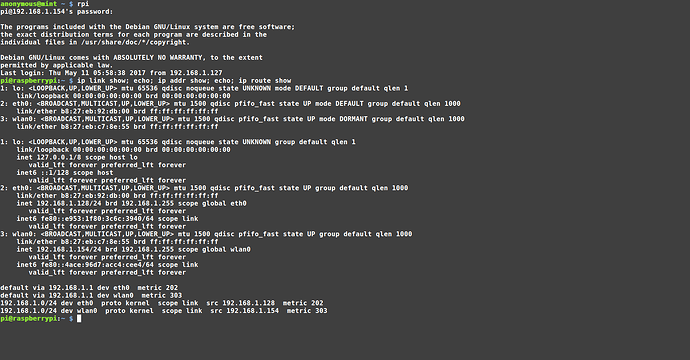

What confuses me a bit about your setup is this:
The output is missing "DHCP_ROUTER=" directive and
from the screenshot you posted, it appears the Pi-Hole IP has changed into 192.168.1.128
Can you run below and post results here ?
ip link show; echo; ip addr show; echo; ip route show

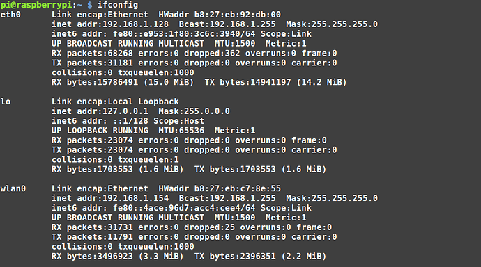

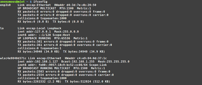

EDIT: the 192.168.1.128 ip is from my linux mint machine, it is my ip not the pihole.
I set a static ip for the pihole via my router dhcp, so it shouldn't change. ifconfig from my linux mint machine:
It has a weird string where wlan0 should be (don't know why or what that is)
ifconfig from the pihole:
You have both the Ethernet and WiFi connected on the Pi-hole?
wifi..possibly so. I actually do have the wifi password for the pihole when I was first setting it up, I connected to the internet via wifi. I then plug in via ethernet from then on.
So yeah, I guess so..
That's probably the issue, down the unneeded interface and try pihole -r
, the dual routes to the internet is confusing things.
turned off wifi and now my ssh doesn't work
You have the Ethernet on the Pi-hole set to the address of 192.168.1.128
yeah just saw that when I did ifconfig on pihole, never knew that
now recalling, I probably did a static ip for the wifi MAC address, not the ethernet MAC address !

Ps. the thing that went wrong was the two default gateways/default routes.
I believe your not allowed to have two.
sudo ip route del default via 192.168.1.1 dev wlan0
EDIT: or add it again if you lose eth0:
sudo ip route del default via 192.168.1.1 dev eth0 sudo ip route add default via 192.168.1.1 dev wlan0

EDIT: I noticed the pihole -d still says
IPv4 on eth0
Gravity configured for: 192.168.1.154/24
So I ran a pihole -r and entered in the correct settings, reboot, and then did another pihole -d, so here's the updated pihole-d and the catted log after a pihole -r:
