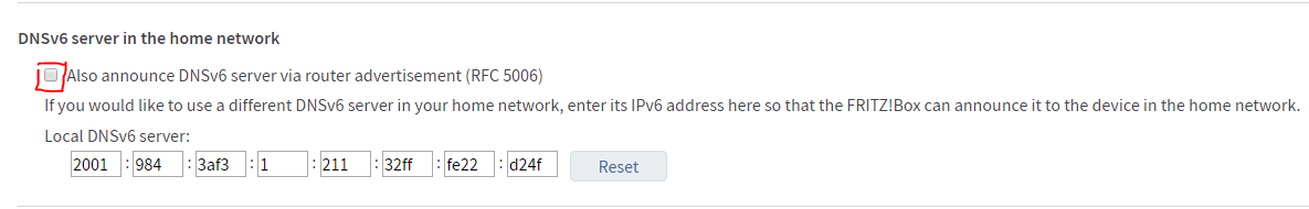

Back to the matter at hand, the android devices. I noticed they used IPv6 for queries when being served by pi-hole. So I looked into my fritz.box network settings for IPv6. I had added the IPv6 DNS address for the pi-hole there and checked the checkbox "Also announce DNSv6 server via router advertisement (RFC 5006)" checked.
Unchecking that box solved the issues on my android devices for me.
At first I was worried this meant the android devices wouldn't use pi-hole for DNS requests anymore, but the tail tool for the pihole.log showed me it did.
Happily enjoying fast ad-free browsing on all my devices in network now.
I know it's pretty specific solution for fritz.box devices, but maybe it helps others.

Thank you so much for figuring this out.
I can confirm that disabling RFC 5006 fixes the performance flaws of Android devices in the network.

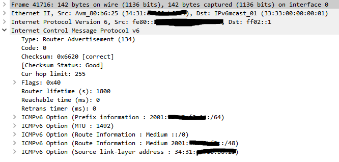

I'm not familiar with Wireshark or networking, but I ran it for you.
Got 5 packets from the filter from turning RFC 5006 on and back off again. What I see is that the RFC 5006 packets have a length of 166 and without 144.
Hope this output helps. Lemme know if you need anything else or how I should export the data.
41716	191.729741	fe80::3631:c4ff:fe80:b625	ff02::1	ICMPv6	142	Router Advertisement from 34:31:c4:80:b6:25
41895	192.560649	fe80::3631:c4ff:fe80:b625	ff02::1	ICMPv6	166	Router Advertisement from 34:31:c4:80:b6:25
46759	214.714213	fe80::3631:c4ff:fe80:b625	ff02::1	ICMPv6	166	Router Advertisement from 34:31:c4:80:b6:25
134796	626.204757	fe80::3631:c4ff:fe80:b625	ff02::1	ICMPv6	166	Router Advertisement from 34:31:c4:80:b6:25
134977	627.030458	fe80::3631:c4ff:fe80:b625	ff02::1	ICMPv6	142	Router Advertisement from 34:31:c4:80:b6:25

Thanks. That worked well, it seems, but those outputs are rather hard to parse for a human :wink: Could you make some screenshots showing the interpreted content?

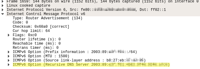

Like this one (captured on my network):
The highlighted line is the one which tells my devices the address of my Pi-hole (but I'm also using the Pi-hole DHCP server). What you can already see (in the very first line), my packets are 144 bytes long as yours with disabled option.

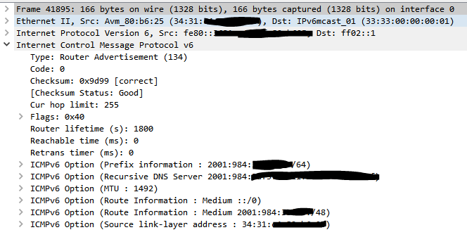

Hope this parses better:
144 bytes:
166 bytes (RFC 5006):
Yes, Thank you. However, that is quite strange, since for you the version that does not contain the Recursive DNS Server info works better
In contrast, I have found that for me only the version with this makes the DNS server also work with IPv6.
Your configuration simply lets the IPv6 server unspecified and the Android devices will only use the IPv4 address of your Pi-hole to get both, IPv4 and IPv6 query answers - which is perfectly fine by the way!
