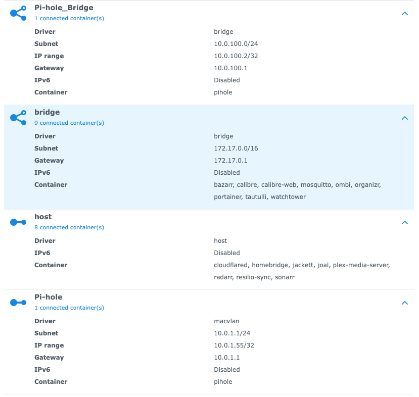

Hello Beefyfish
Thank you for this amazing how-to which works like a charm on my DS918+.
I followed your advice and ran the visibilityspots/cloudflared image, checked "Use the same Network as Docker Host" and set my upstream DNS to 10.0.100.1#5054.
Everything works well but I would like to understand why does the upstream DNS needs to points towards 10.0.100.1, which, when following your how-to, is the IP of the Macvlan bridge gateway.
Since we checked the "Use the same Network as Docker Host" I have a hard time understanding why we are using this IP address here.
So I'm not reporting any issue here but just trying to understand and learn!
Thanks again for your amazing work!
Cheers!

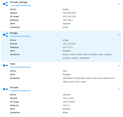

Also, I just noted something strange.
Since I created the "Pi-hole_Bridge" and "Pi-hole network", all containers associated to my original "bridge" network do not have access to internet anymore.
I realized that modifying the container and checking the "Use the same Network as Docker Host" solved the issue, but I do not understand why this "bridge" network is not working anymore.
The docker host is not allowed to talk to the macvlan on your network for security reasons built inside docker. We use a Docker bridge network to circumvent this restriction.
As towards your other bridge network not having internet did you point your synology DNS to the Pihole_Bridge? If you did not do this your synology will ask the router for the DNS location and it will try and send it to the macvlan and timeout because it is not allow to talk to it. Also make sure you set a static IP on your synology if you have not.
If you have all this setup did you reboot? I have had many times when doing complex things that the ip tables would not update on my synology and a simple reboot would correct them.

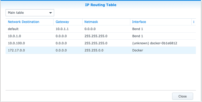

Thanks for your quick response!

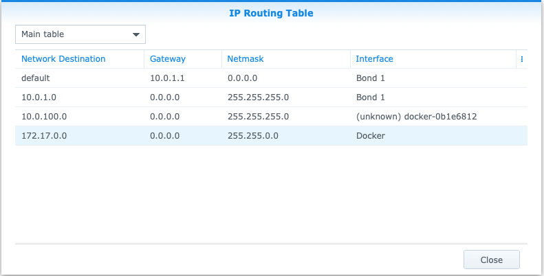

I did everything, pointing the synology DNS towards 10.0.100.2 (the IP range, not the gateway as indicated in the how-to), my NAS has also a static IP address with DHCP reservation. I also rebooted the NAS and when going to Network -> Static Route, I can see the following in the "Main table" menu:
Any idea?
Does your package center have internet?
Yes it seems to as it retrieves the list of community packages.
Also, I rebooted once, it seemed to solve the problem as one of my package connected to the bridge (Ombi) got internet back.
I rebooted once again and am now back to the same situation, but package center still has access to internet.
