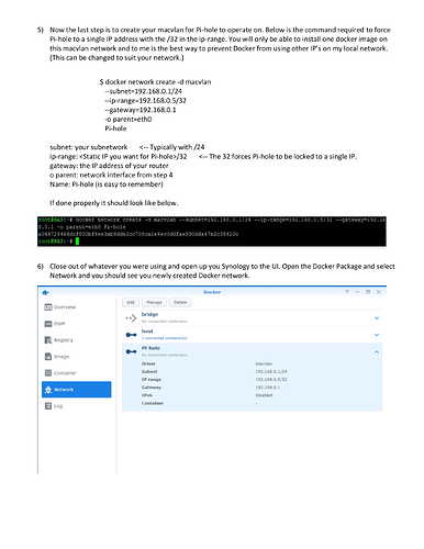

If you ssh into your Synology as a root user and use the following command:
docker network create -d macvlan /
--subnet=192.168.0.0/24 /
--ip-range=192.168.0.5/32 /
--gateway=192.168.0.1 /
-o parent=eth0 Pi-hole
This will create a macvlan with the ip forced as a single ip (192.168.0.5) to use as a network for your docker image.You can then create your pi-hole docker image all through the UI now as this network will show up in docker. No port forwarding or anything is needed for your docker image just select Pi-hole as your network and delete bridge in the network section of the interface and set the ServerIP.
Using an IP calculator you can configure this to a single ip in ip-range section of the command.

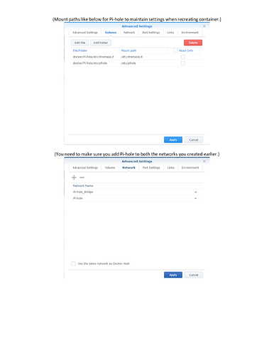

I mean complete setup by binding volumes for the etc/pihole and etc/dnsmasq.d to maintain settings even after deleting my docker image or restarting the synology. Pi.hole in the browser takes me to my pihole page. Everthing I tried works as expected and functions just like my pi3 install.

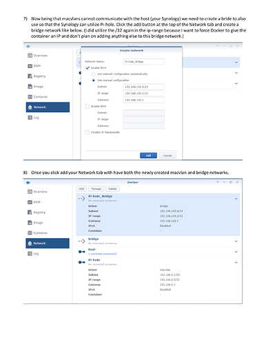

I dont have it set as my DHCP yet because I plan on doing an easy setup guide to install this through the GUI as tony's UI guide is a little outdated. But to use DCHP it should be as simple as setting a static IP on the synology as pihole is not actually running until the synology has booted completely.
I did manage to get a cloudflared docker instance working but its not quiet how I would like it as I had to send the pihole to the router and have the router send requests from the pihole to the cloudflared container due to the Linux kernel blocking macvlan communication to the host.

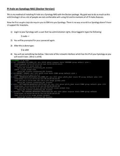

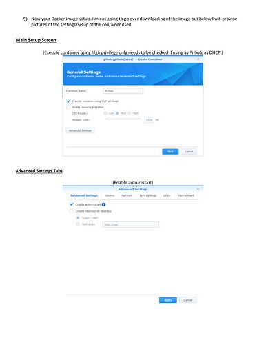

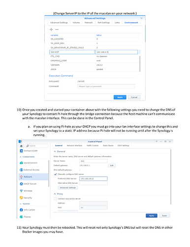

Ok here is a little write up I did. I was unable to load the word version to the site so I uploaded the a zip file with the original document but attached pictures of the write up.
The only downside of this is it will only show an IP for the Synology in the pi-hole interface because the Synology uses pi-hole through a docker bridge being that it is unable to contact it through the macvlan.

Only issue I encountered was that setting the DNS for the NAS to 192.168.100.2 didn't work. It would break quickconnect functionality and also couldn't connect to the docker repository. I fixed it by just setting the DNS for the NAS to 8.8.8.8 as it doesn't need adblocking anyways.

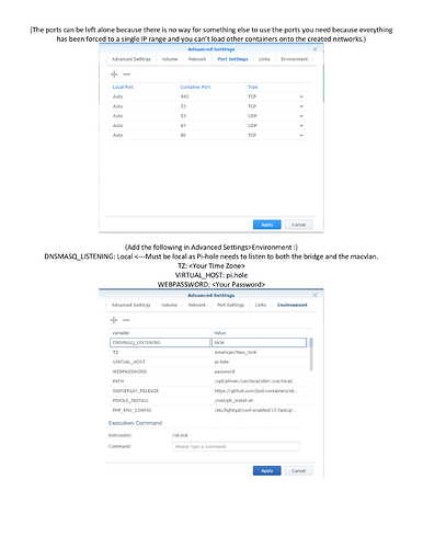

I had that issue when first trying this install. In your setup of the docker image did you make sure to set DNSMASQ_LISTENING: Local? Without it set to local pihole will not listen to the bridge interface you created and will only listen over the mcvlan which the host device is unable to do because of the security of a mcvlan.
Edit: If I remember later when I get home ill look into it further. One of my big requirements for running pihole on my NAS was that all network device had to use it.
For me this also did not work (defining 192.168.100.2 as DNS server). I did set DNSMASQ_LISTENING to local. Did you look into it further?
I havent had time to look at it but I definitely will tonight.
If you happen to be around your pihole could you try going to you pi.hole page and in the setup change it to listen to all interfaces and apply that to see if it works?
ok, I looked at this tonight.
I have to ask but did you make sure to add your docker image to both the pihole and pihole_bridge networks?

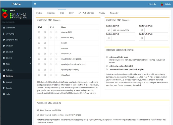

If so can you please look to see if listen on all interfaces is selected like below?
Resolving this issue so your Synology can use pihole is more then just your Synology. All of your docker containers use the same DNS as your Synology. This will also give you the ability to run cloudflared or other DNS docker images that your pihole can use. As you see from the picture above my pihole goes back to a cloudflared docker image.

I used the visibilityspots/cloudflared image. The only thing you should have to do is make sure to select "Use the same Network as Docker Host" in the Advanced>Network tab when creating the image.
Then point your Upstream DNS to the IP of your NAS bridge with #5054 at the end for the port.
You may need to set it to port #54 now as the docker file is showing.
CMD ["/bin/sh", "-c", "/usr/local/bin/cloudflared proxy-dns --address 0.0.0.0 --port 54 --upstream https://1.1.1.1/.well-known/dns-query --upstream https://1.0.0.1/.well-known/dns-query"]
He either changed the port at some time or the shown dockerfile has an error. The easiest way to verify the port he has set is to export the docker settings and open the config file as it will show the CMD at the top.
Yeah, I`m done... Now it works great for me. I used the same IP as you for this DoH-Service (192.168.100.1, same setting on Syno+Docker). Cloudflared currently uses Port 5054.
