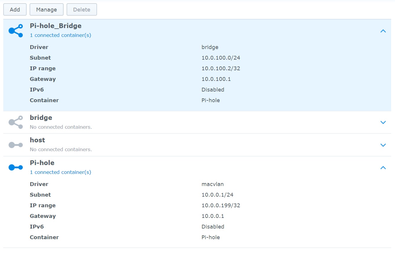

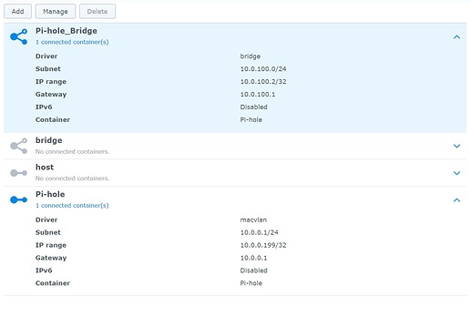

I setup like this to maintain pi.hole as the address for my pi-hole. Synology NAS will not give up port 80. The way I wrote it up it is almost like another computer on your network.
With the error you received I think you may have messed up an address while creating the macvlan or the network port. I dont know how your network may be setup so using the numbers provided in my write up are example addresses unless your network is like mine.
My domain is on 192.168.1.x and my synology is on 192.168.1.2, with gateway on 192.168.1.1
my macvlan is hence on 192.168.1.1/24 and IP range 192.168.1.3/32
Pi-hole_Bridge I have kept identical to yours, so in my mind looks to be right?
That would be correct. If you attempt to retry making it you have to make sure to delete the existing macvlan through the webui before retrying.
I do know that if you are using virtual machines or network interfaces it will effect if you should be using eth0 or another network port while creating the docker image.

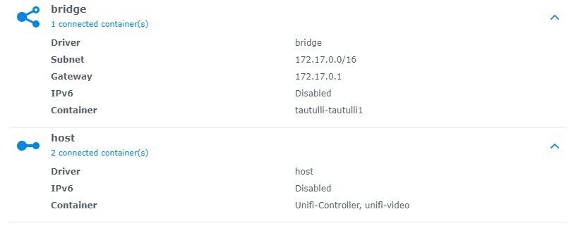

Have tried this a few times, with slightly different settings. Same error everytime it looks to be port related but there is no setup for ports in this. I am also running tatulli and a couple of unifi controllers, see other networks in docker, but don't think they should conflict? Other than that my syno is pretty standard.

Hi beefyfish thanks for the tutorial , could you clarify the subnet ... I am not clear between your post and the pics
One ends with 0 ...
my gateway is 10.0.0.1 and nas is at 10.0.0.35 .. what would be my subnet ?!
When i ping 10.0.0.199 i get
Reply from 10.0.0.35: Destination host unreachable.

It looks as you have everything setup right. Your issue is that you are not allowed to ping 10.0.0.199 from your nas. As a host is not allow to talk to a macvlan docker image. The subnet in the bridge really isnt that important (you could change the /24 all the way down to /30 to limit ip's if you desired) as the only things connect to that bridge are pihole and the host machine.
You need to make sure you set the dns on the nas to talk through the bridge connection you created (step 11). This is a work around the so you host machine can talk to the docker image. Just verify the connection in the pi-hole UI when the synology sends out a dns request (open package center).

You will not be able to ping 10.0.100.1 or 10.0.100.2 with a PC on the network as it is a virtual network created inside docker on your synology. Your synology should have the dns set to 10.0.100.2 and it will communicate to pihole through this network as it is not allowed to through 10.0.0.199 due to docker security.
Your router dns should point to 10.0.0.199 if you were able to connect to the pihole interface.
If you were unable to access pi.hole or 10.0.0.199/admin I would just delete the image and all the created networks and try again as one small issue during install can really mess things up (pay close attention to any IP address that you may need to change). I would also try to set the macvlan outside any address range your router can assign so it doesn't accidentally assign that address to another device.
You were right to select bond0 if that is what "ip addr" showed if your using the dual network ports bonded. Otherwise it would be eth# or ovs_eth# (if open v switch is enabled). Either way you must use the proper port or the macvlan will not work.
