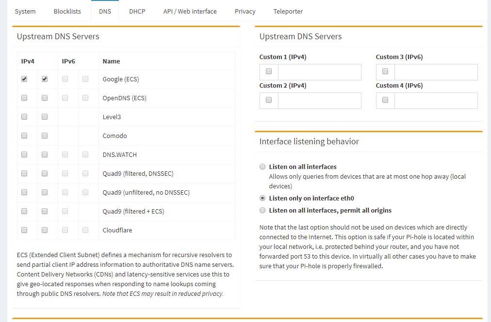

Hi guys, i have a Pi 3b set up with diet pi and running the latest release of pi hole. Its connected via eth to my tp link vr900 router. However it is only semi working on most devices.
So my connected devices via cable seem to function fine. Browse the web and so forth. And apparently show on the clients list for pihole. There are some query's but not as many as i would have thought and my test site (speedtest.net), when previously used with a virtual machine of pi hole, managed to block all adds. Not now.
And my wifi devices all on a 2.4ghz network setting at the moment ( issues with a security camera ive yet to fix). Android devices like my phone and tablet tell me im connected but have no internet.
Second i remove the dns setting in the router config page. Normal internet traffic resumes. Im kinda stumped.
