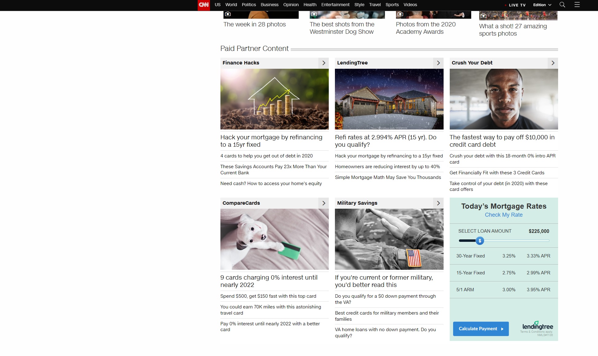

Ok I loaded cnn.com on a browser with no ad-blocker installed. I see "paid partner content" both on the right and near the bottom. See example attached.
One thought: do I need to restart (either the PC or my connection to the network) in order to get the benefits of Pi-Hole after setting the DNS?
