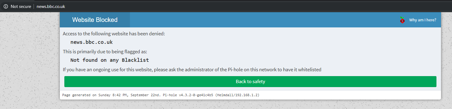

If I add a rule to redirect all non https traffic back to 192.168.1.2 that works exactly as expected (ie I get the default blocked page) so that says to my mind that the "rule" or "logic" or whatever you want to call it is correct.
So why do I get that nslookup error/timeout when specifying anything other than pihole with the same rule (other than port number) applied?
/me scratches head
pi@Heimdall:~ $ sudo iptables -t nat -A PREROUTING -i eth1   -p tcp --dport 80 -j DNAT --to-destination 192.168.1.2:80

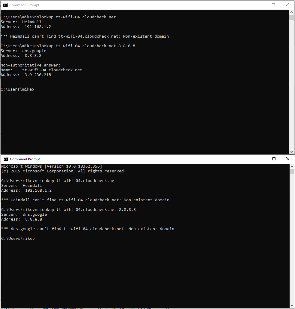

Top half below is the test results from my laptop configured statically as:
Static IP : 192.168.1.10
DNS : 192.168.1.2
DGW : 192.168.1.1
In the lower half the DGW was changed to 192.168.1.254 which is eth1 on the Pi, as you can see DNS requests to 8.8.8.8 now give the same response as going directly to the PiHole
