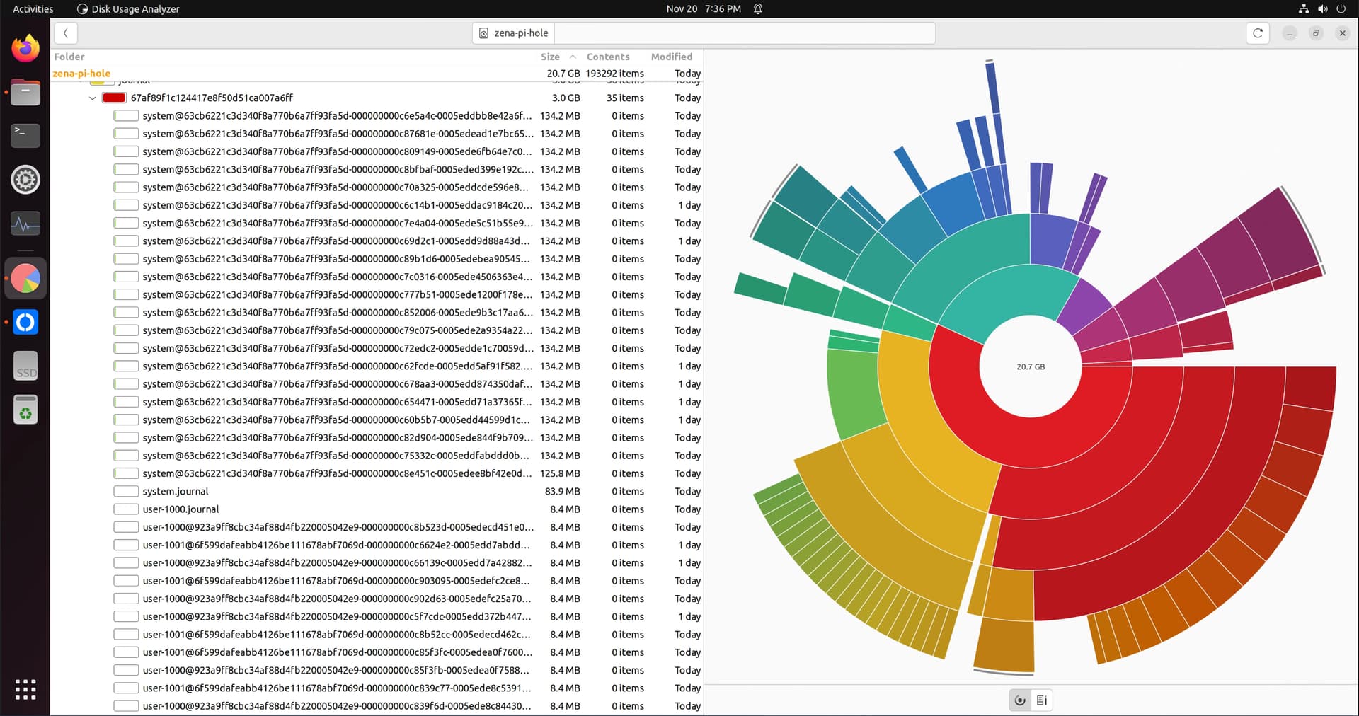

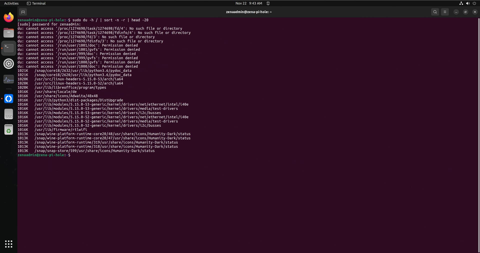

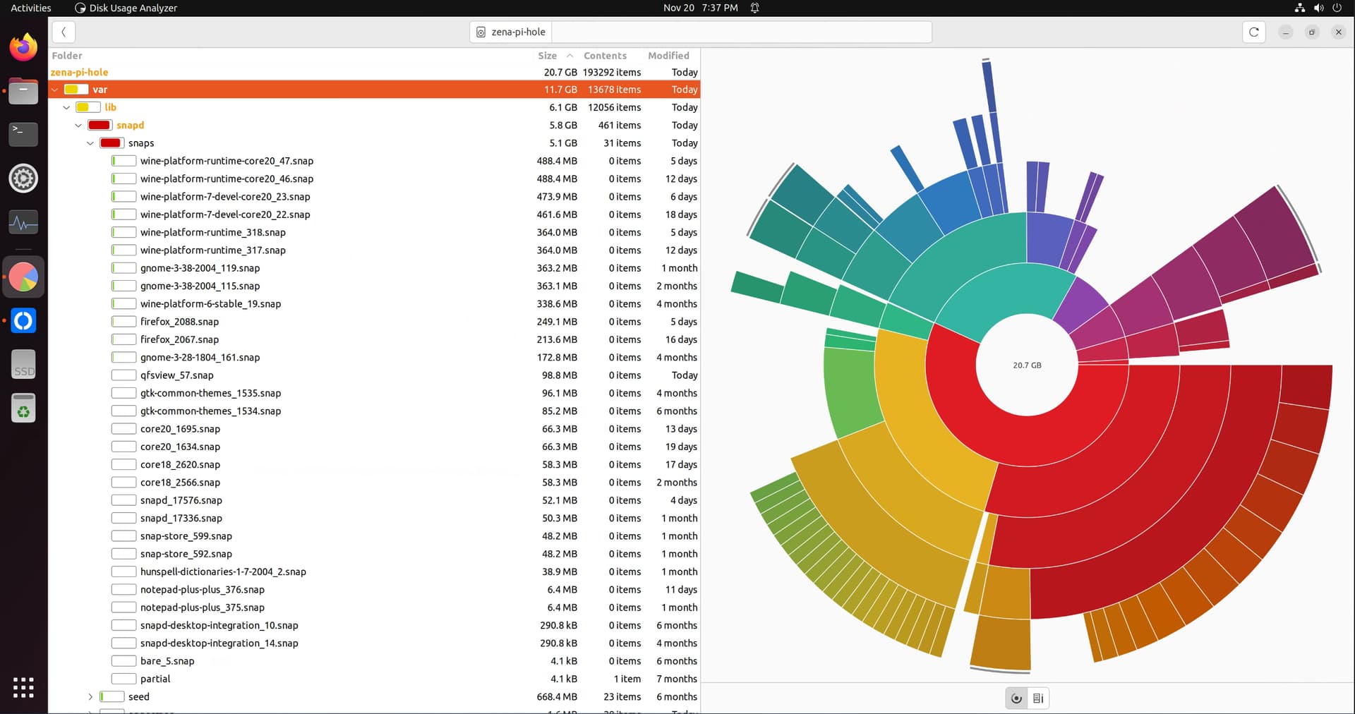

Running out of space very quickly
Despite following instructions elsewhere when I have gotten a " Disk shortage (/etc/pihole/pihole-FTL.db) ahead: 91% used" and " Disk shortage (/var/log/pihole/FTL.log) ahead: 91% used" it seems these files take up space faster and faster.
I cleared them yesterday and now they are full. I don't think anything has changed.
I did try and search for solutions but other than manually clearing the log, I really didn't understand the solutions offered.
Aren't these logs supposed to self-reset? How would the get so big.
I have pi-hole running on Ubuntu 22 on a cheap Intel system on a chip from China. Ubuntu and Pi-hole are up to date.
I don't believe anything has changed other than updates.
I tried attaching the diagnostic output but it says the post is too long.
Any help appreciated.

Run this command to see the 20 largest directories. One (or a few) of these is where your space is being consumed.
sudo du -h / | sort -n -r | head -20

I found a tool in Ubuntu that estimates folder sizes. Any insight at what I am looking at and if the offending files "can go" is appreciated.
Also note that this is only used for Pi-Hole, so other than the operating system itself, and RustDesk used to connect remotely to the desktop, there shouldn't be anything else making space.
Output from terminal command.
Fixed...
So, I found out that Snapd was causing the issue with some package and log files. I managed to delete them but now I can't add software. Oh, well. I wasn't planning on adding anything anyway.
