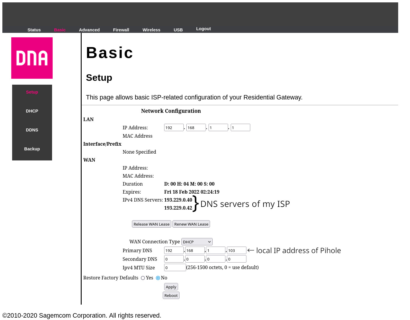

I just recently set up a Pi-hole sinkhole and got everything working nicely. I configured Pi-hole as the primary DNS server in the router settings. However, from the web interface I noticed that query logs seemed to always end to previous day at 11 PM with PTR type requests to 8.8.4.4 and 8.8.8.8. At first I didn't think too much about it, but as this happened everyday I started looking into it. So, it seems that my router for some reason overrides the set Pi-hole IP with my ISP's own DNS server IPs everytime the global IP of the router expires. The router changes back to Pi-hole as DNS server when I reboot the router.
Any suggestion how to fix this? The settings of the router are a bit vague.
My router is Sagemcom F@ST 3686 with ISP customized firmware.
