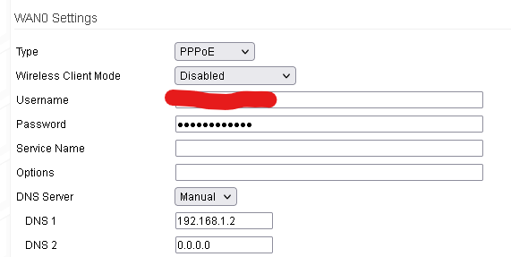

If you're already advertising the Pi-hole IP as a DNS server to the clients through the routers DHCP service, try defaulting below setting:
Thanks for your reply.
This setting is defaulted in the router:

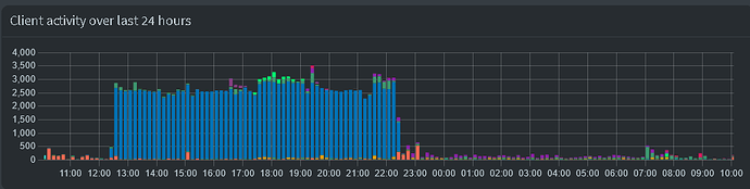

What is strange is it seems to occur in phases:
The blue is the router requests to the Pi-hole.

How can the settings in the screenshot be the OOTB factory defaults with that 192.168.1.2 IP?
Did the factory know about your 192.168.1.2 Pi-hole IP before they shipped the router?
Try again :wink:
The default setting is Auto. This picks up the ISP's DNS servers from the WAN DHCP and hands this out to the clients so the Pi-hole isn't used.
