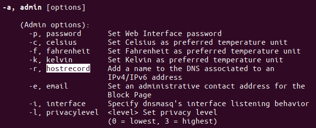

It does, this is the expected behavior, quoting man pihole:
where it says an IPv4/IPv6 address.

I just checked the description there - it is doing exactly what it is supposed to do.
Furthermore, the help confirms this:
$ pihole -a hostrecord -h
Usage: pihole -a hostrecord <domain> [IPv4-address],[IPv6-address]
Example: 'pihole -a hostrecord home.domain.com 192.168.1.1,2001:db8:a0b:12f0::1'
Add a name to the DNS associated to an IPv4/IPv6 address
Options:
  ""                  Empty: Remove host record
  -h, --help          Show this help dialog
Note that many of the -a options should not be used directly. They are used internally by the pi.hole/admin interface (hence the a). Their behavior might change at any time and without further notice when this is necessary for the proper function of the dashboard.
We are trimming the dashboard to use less and less CLI commands in the backend, so be prepared that these internal commands may simply disappear at some point. Again, without further notice.

edit: Added man page screenshot + marked unnecessary comments appropriately.
