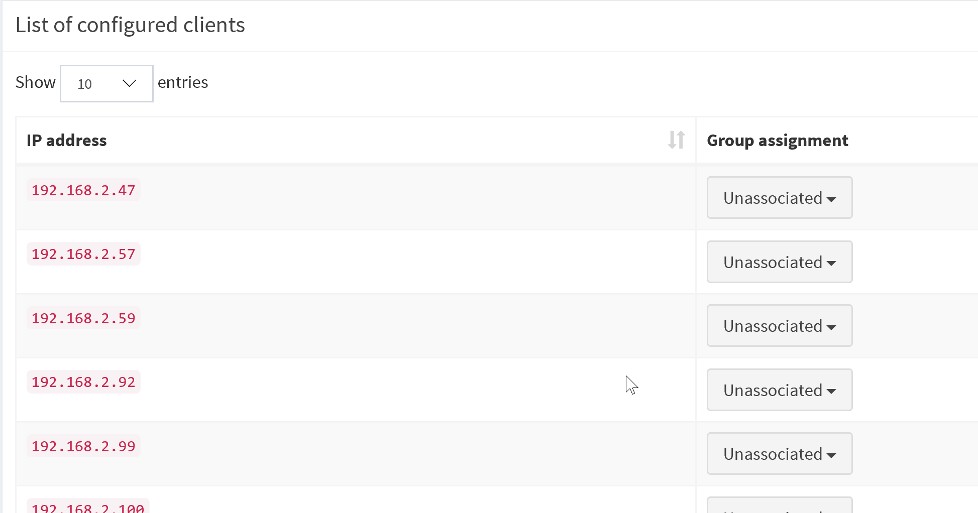

Request: add comment field to client table
I'm trying to get acquainted with group management.
When entering clients by IP address, it rapidly becomes unclear which client represents a device, the table looks like this:
Would it be possible to add an optional comment field.
