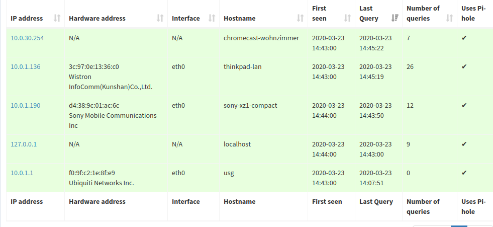

The first neigh entry for `10.0.1.190 was incomplete but no mock-device was added.
Mo 23. Mär 14:43:45 CET 2020
10.0.1.190 dev eth0 INCOMPLETE
10.0.1.1 dev eth0 lladdr f0:9f:c2:1e:8f:e9 DELAY
0.0.0.0 dev lo lladdr 00:00:00:00:00:00 NOARP
10.0.1.136 dev eth0 lladdr 3c:97:0e:13:36:c0 REACHABLE
ff02::1:ff42:dae4 dev eth0 lladdr 33:33:ff:42:da:e4 NOARP
ff02::2 dev eth0 lladdr 33:33:00:00:00:02 NOARP
ff02::16 dev eth0 lladdr 33:33:00:00:00:16 NOARP
::1 dev lo lladdr 00:00:00:00:00:00 NOARP
Mo 23. Mär 14:44:45 CET 2020
10.0.1.190 dev eth0 lladdr d4:38:9c:01:ac:6c STALE
10.0.1.1 dev eth0 lladdr f0:9f:c2:1e:8f:e9 STALE
Mo 23. Mär 14:45:45 CET 2020
Mo 23. Mär 14:46:45 CET 2020
10.0.1.190 dev eth0 lladdr d4:38:9c:01:ac:6c REACHABLE
10.0.1.1 dev eth0 lladdr f0:9f:c2:1e:8f:e9 REACHABLE
And here comes the failed one (10.0.1.64)

No false positive mock-device ![]()
INCOMPLETE and FAILED entries are handled similarly now (we wait for more information to arrive).
