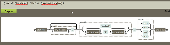

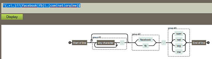

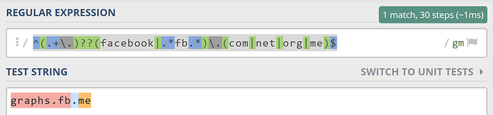

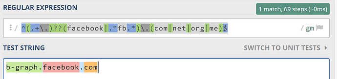

After playing with the online regex tester and regexper, I came up with the following:
^(.+\.)??(facebook|.*fb.*)\.(com|net|org|me)$
this covers all the domains(online regex tester), covered in the reddit article, and the article it refers to, examples:
and
Regexper shows the following:
Is this a good regex, or does it go to far (covers domains you don't want to blacklist)? All comments are welcome...
Using a regex here as opposed to blocklist (better solution), because it's impossible to keep up with new facebook domains.
edit
just realized I could remove the wildcard for 'fb', thus using:
^(.+\.)??(facebook|fb)\.(com|net|org|me)$
still would like to know which one you recommend...

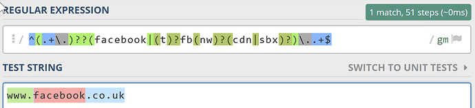

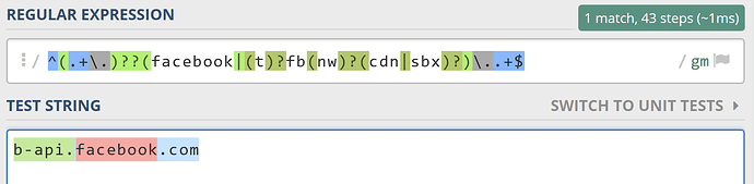

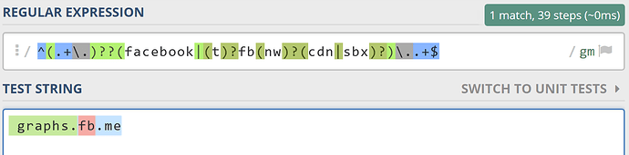

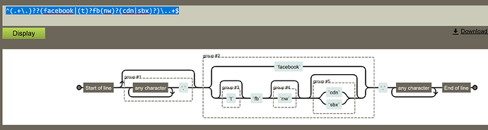

compiled from your suggestions, how about this:
^(.+\.)??(facebook|(t)?fb(nw)?(cdn|sbx)?)\..+$
and
and

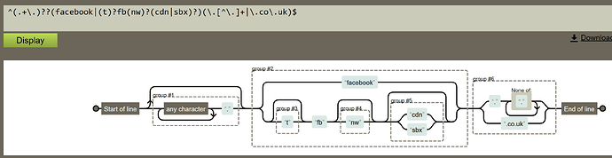

regexper:
I would personally keep the tfbnw separate as it will likely never appear as the full tfbnw and it could be introducing extra steps checking for those optional characters every time
You can leave as wildcard at the end if you like but bear in mind this opens up to matching stuff like fbcdn.test.com etc. Maybe not a huge issue but sometimes have to be careful. If the list of tlds is small I would explicitly state them in an or statement at the end :slight_smile:
Or look at whether extended regexps would support something like \.[^.]+$ (dot, not dot, to end of string)
and your proposed regex would than be?
I will do some experiments when I can get to my laptop :slight_smile:
^(.+\.)??(facebook|(t)?fb(nw)?(cdn|sbx)?)(\.[^\.]+|\.co\.uk)$
www.facebook.co.uk -> match, 63 steps
graphs.fb.me -> match, 41 steps
b-api.facebook.com -> match, 45 steps
www.fbnw.com -> match, 46 steps
www.tfbnw.com -> match, 47 steps (only one step more for tfbnw)
fbcdn.test.com -> NO match, 64 steps
regexper:
