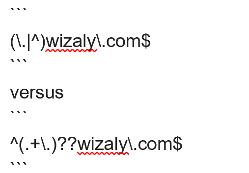

another attempt to list the regex
(\.|^)wizaly\.com$
versus
^(.+\.)??wizaly\.com$
and a screenshot of what I type
