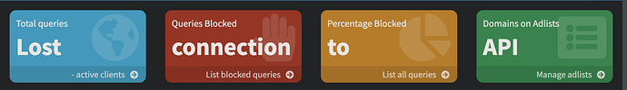

Recent update has cause connection to API issues. Also "Failed to Fork"
The issue I am facing:
After update, I get this error on home screen:

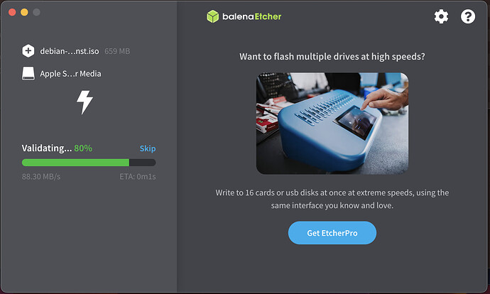

You have the command to reflash it?
There is no single command to reflash an OS. Typically you would use something like Balena Etcher or Raspberry Pi imager to put an OS on an SD card.
From there, mount the card in the Pi, ssh in and install Pi-hole.

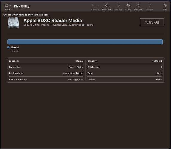

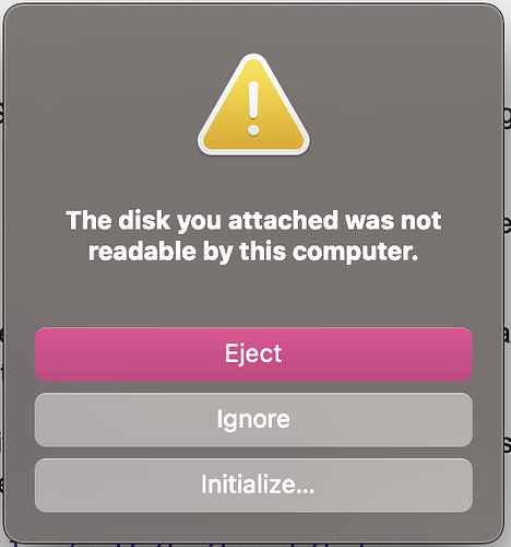

This is the error I get when I attempt to plug the SD card into my mac. Ignore and initialize seem to do nothing.
This is what the initialize screen looks like:
The "first aid" and "erase" do nothing. It shows it is capped on storage but SFTP showed it having room, clearing logs also cleared 2 gigs of data

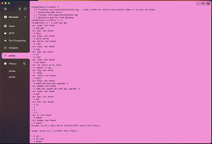

~ # sudo apt update && sudo apt upgrade -y
-sh: sudo: not found
Managed to make things worse lol
~ # apt get
-sh: apt: not found
~ # help
-sh: help: not found
~ # hello world
-sh: hello: not found
~ # root
-sh: root: not found
~ # log
-sh: log: not found
~ # cd
~ # root
~ # cd /boot
-sh: cd: can't cd to /boot
~ # reboot~ # log
-sh: log: not found
~ # -help
-sh: -help: not found
~ # help
~ # pdate && sudo apt upgrade -y
-sh: pdate: not found
~ # apt
-sh: apt: not found
~ # APT
-sh: APT: not found
~ # ls
~ # a
-sh: a: not found
~ # Uname
-sh: Uname: not found
~ # touch
BusyBox v1.16.1 (2011-08-23 13:02:26 PDT) multi-call binary.
Usage: touch [-c] [-d DATE] FILE [FILE]...
~ # cd /
/ # cd root
~ # Uname
~ # ipconfig eth0
-sh: ipconfig: not found
~ # passwd
Changing password for root
New password:
Retype password:
passwd: /etc/passwd: Read-only file system
passwd: can't update password file /etc/passwd
~ # tail -f /var/log/syslog
tail: can't open '/var/log/syslog': No such file or directory
tail: no files
~ # scp
usage: scp [-1246BCpqrv] [-c cipher] [-F ssh_config] [-i identity_file]
[-l limit] [-o ssh_option] [-P port] [-S program]
[[user@]host1:]file1 [...] [[user@]host2:]file2

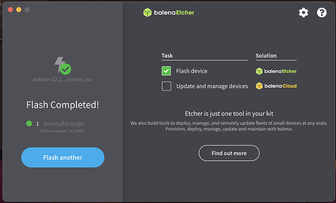

I am flashing linux-6.4.11-kirkwood-tld-1-bodhi.tar.bz2 now instead of the debian OS even though debian was what was there before
That yielded the same results of "all commands not working"
Now trying: Debian-jessie-3.18.5-pogoplug-v4-20151110-disk-image.4GB.img.zip
