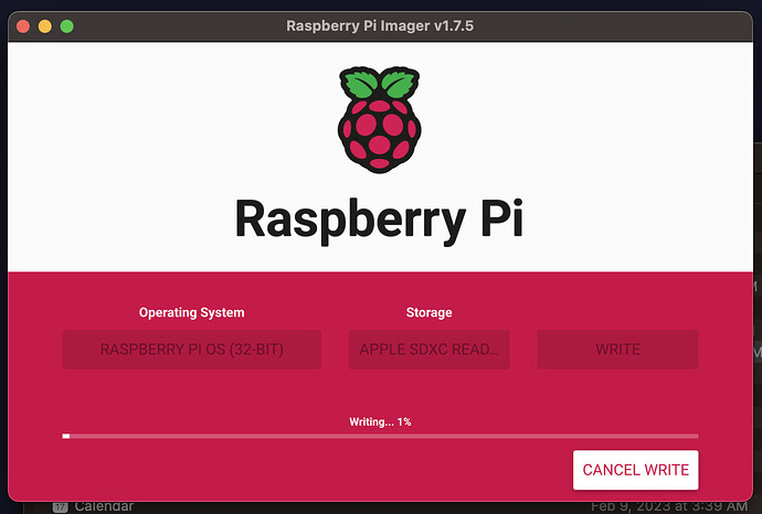

You should try the Raspberry Pi Imager:

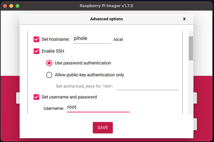

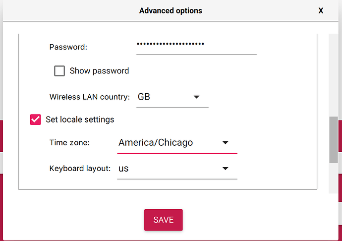

The Imager has some nice options to use. In the Advanced options, activate ssh, set your location and time zone, put in your WiFi credentials if you are connecting the Pi via wireless, and most importantly, set a user ID and password.

Flash it again, this time setting the options.
got that going now

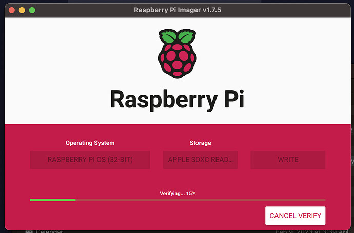

edit: now verifying

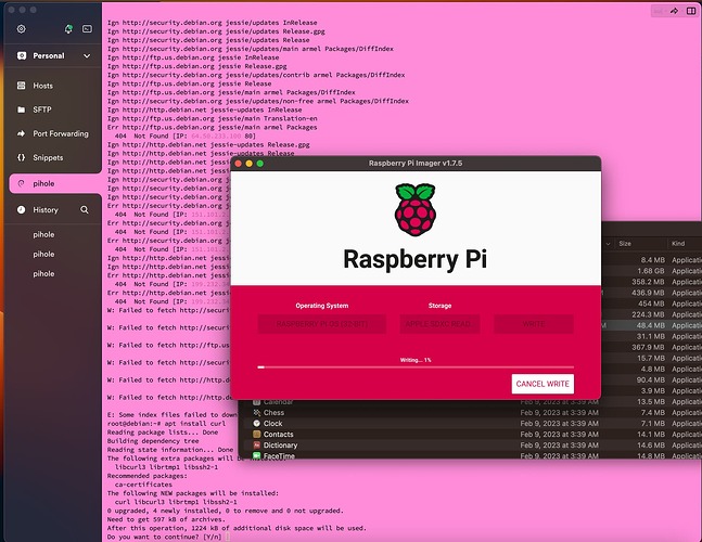

I messed something up:
~ # help
-sh: help: not found
~ # sudo apt get
-sh: sudo: not found
~ # date
Thu Jan 1 00:02:25 UTC 1970
~ # time
BusyBox v1.16.1 (2011-08-23 13:02:26 PDT) multi-call binary.
Usage: time [OPTIONS] PROG ARGS
~ # sudo apt upgrade
~ # apt upgrade
-sh: apt: not found
~ # apt update
-sh: apt: not found
No idea what. Reflashing now
ß # reboot
ß # help
ß # apt update
-sh: apt: not found
ß #
all commands are failing again
