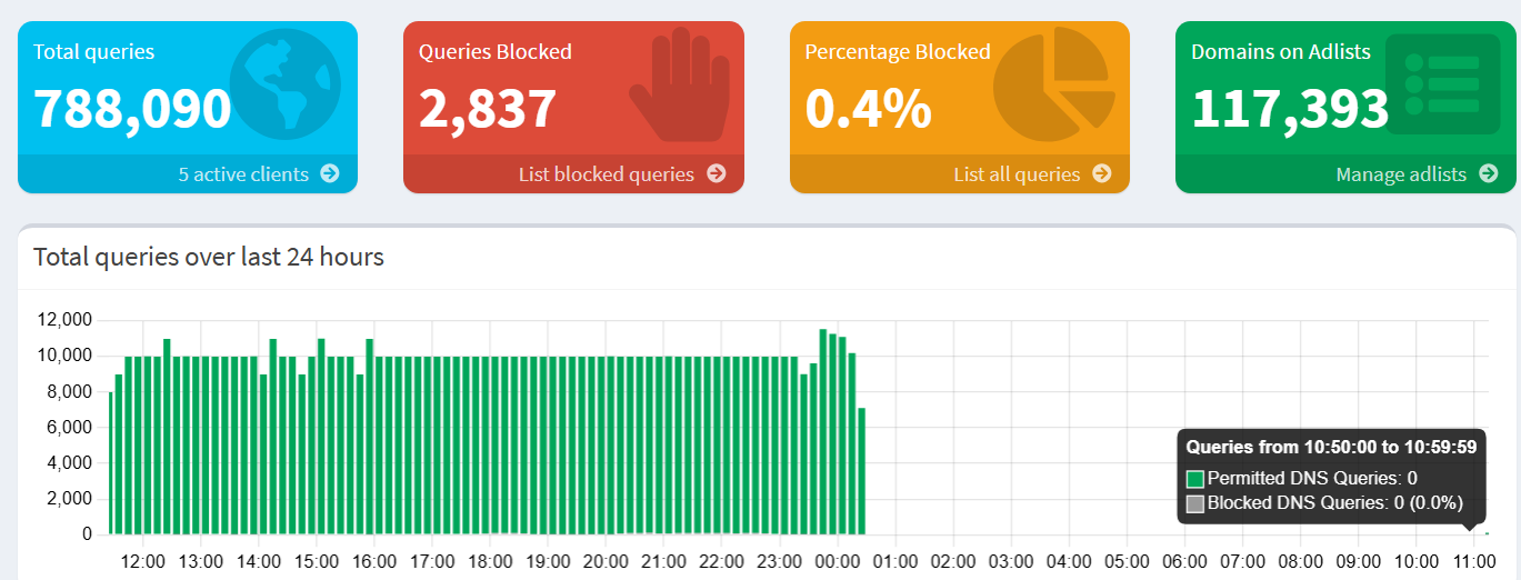

I have turned off the Pihole as I don't understand what is happening as I have so many queries, see the insert and the bottom of this post, if I do have a loop, which maybe the case I don't know how to rectify it. I have a fresh install and do not want to change things and make the problem more complicated!!!

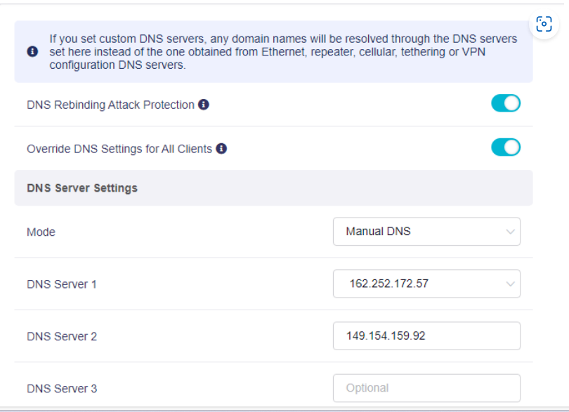

I think the issue may not be helped by the strange way you have to have to allocate a Manual DNS in the GL.iNet GL-AX1800(Flint) router. This are not my settings but I have the Mode set to Manual DNA and in DNS Server 1 the fixed address of the pihole, DNS server 2 in blank, the two options are also selected on my router. There is a third setting on my router "DNS Rebinding Attack Protection" this is also selected.
