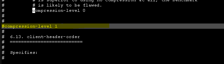

nano /etc/privoxy/config
then do CTRL+W which brings up search: Search For # 6.13. client-header-order
Right above it it will have the words #compression-level 1 (See the picture below)
The Yellow Highlighted part allows you to save bandwidth via compression by default it does lzo78 compression but you can choose from 3 others compression types.

**To get faster internet with Privoxy change the highlighted section to 7 if you choose to do 8 or 9 the max compression most sites won't have clickable links and videos may or may not work. **
