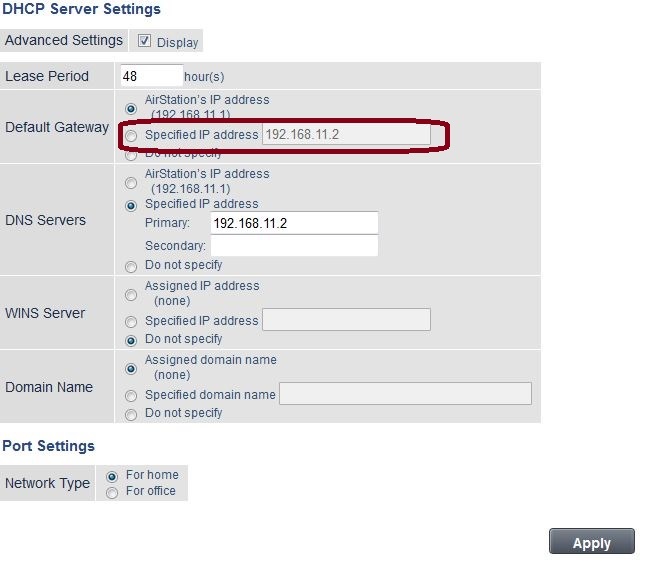

Under the Network Setup (LAN) tab, look under Gateway IP because it may be there. Good luck.
I cant change gateway ip of modem to rpi ip because modem dont let me change may be they conflict ip?

Perhaps, instead of not changing the modem's gateway use bridge mode. Can your modem connect to another router? I think you can turn on bridge mode. Then, you can use your router to change the gateway IP.

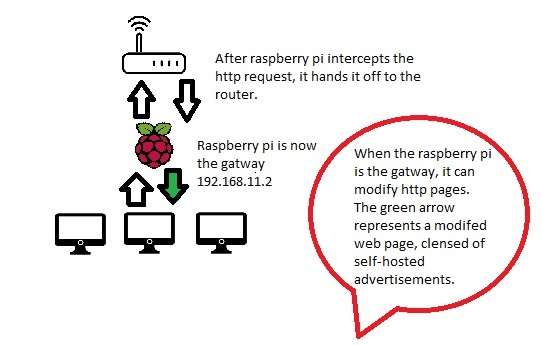

You're right pi-hole is great, I've been using it since the beginning. This was a project to see what over network things the Pi can do. Did you know this type of "man-in the middle" proxy of intercepting a webpage and editing it on the fly is actually used by some ISP?
Using privoxy you can mimic an alert warning an ISP will send out if they catch you torrenting things like game of thrones from the pirate bay. To send you an alert they modify non secure webpages and inject javascript that tells you something like "strike one!" that pops up. This message is persistent on every http page until you accept their terms and close it.
So how does this relate to privoxy? Because you can mimic the way they inject javascript into pages with privoxy and create your own fake popups. Scary! That's what I've learned, so it does have potential. If their was a way to make it the default gateway, without messing with your router it might have had some potential in the project to remove more ads.

Normally to use Privoxy you have to set the address of the pi as a proxy in your browsers settings.
However, you don't have to do this, if you change your default gateway. This shows the network topology in action.

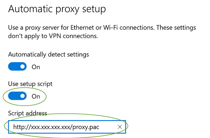

I also found you do not need to change the default gateway (routers gateway) setting, instead, since we already have a webserver, put a file called proxy.pac in /var/www/html, containing the following:
function FindProxyForURL(url, host)
return "PROXY xxx.xxx.xxx.xxx:8118; DIRECT";
change your browsers proxy configuration to use the proxy.pac file (or configure your router, if possible, with an auto proxy configuration setting)
The screenshot below is captured from edge
you need to replace xxx.xxx.xxx.xxx in this post with the IP address of your Raspberry pi

Diverting all traffic through privoxy as gateway makes it slow on a pi (only 100Mbit, slow network performance)
@jpgpi250 With privoxy as transparent gateway there is no need to setup proxy settings on browsers. Your solutions sets a normal proxy functon to the client instead of transparent. Setting both methods (so gateway=pihole and browser proxy url) might cause issues as traffic will/might flow through pihole twice.
Better choose 1 method:
Set transparent using dchp set gateway or configure browser proxy like your screenshot
Better use privoxy as proxy and not as transparent. (You need to setup your browser's proxy settings in that case or have DHCP inform clients about the pac file)
