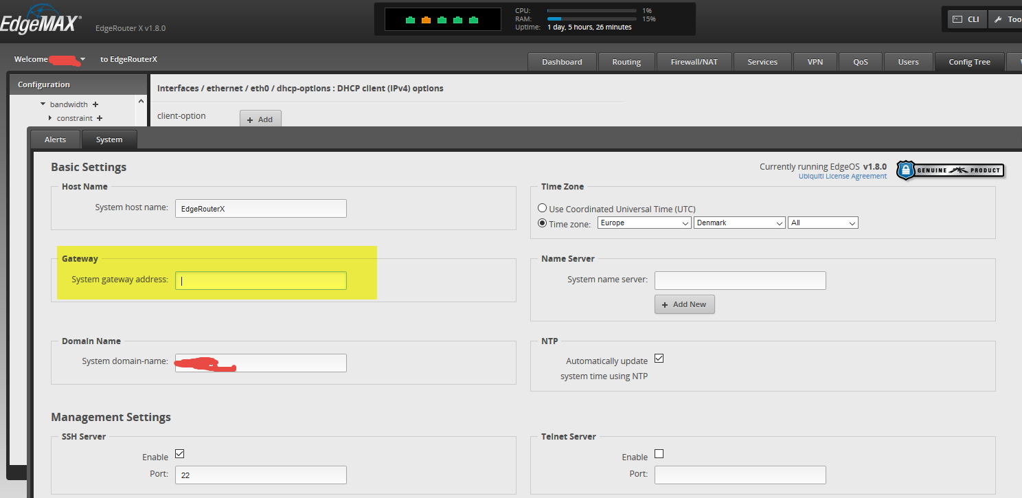

Here's my router config
thx.. I might try this again.. I just found a Docker container of pi-hole & privoxy (2 seperate) so might try running both as docker instead of VM.. :slight_smile:

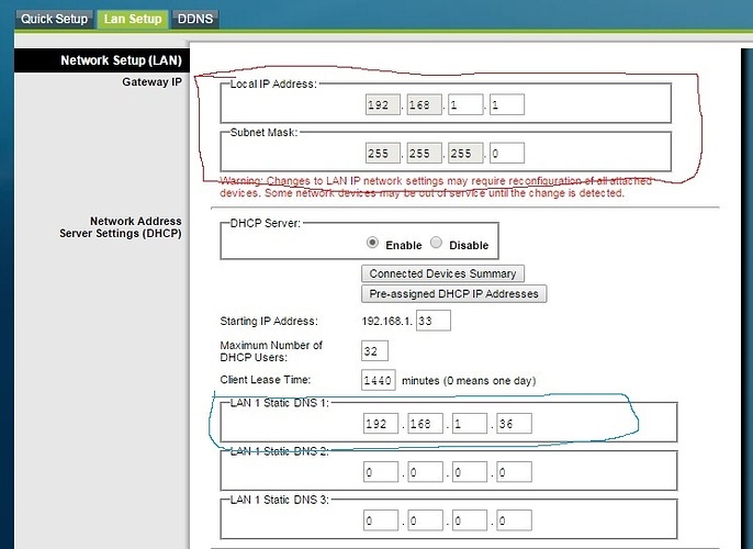

you mean in red box or blue box ?
Blue box is RPi ip from pi-hole.
