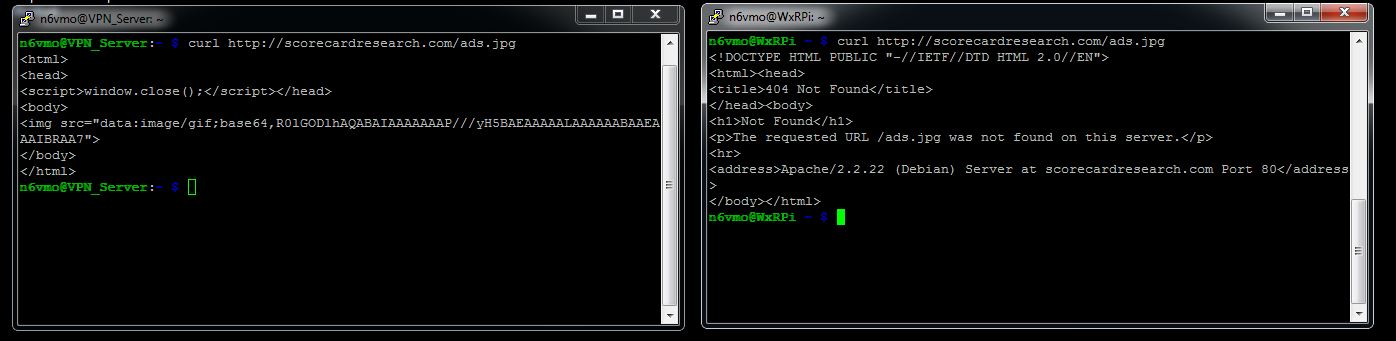

The OP above didn't realize they had broken pihole even though pihole admin interface is accessible by a different port in the browser.
I am not sure that Pi-Hole is rendered useless or is broken by changing the port number for the web admin server in lighttpd.conf. My Pi has been running fine and blocking ads using port 8017. I have used several different ad-blocking test site and confirmed it does block ads while using a port other than 80 to serve up the admin page.

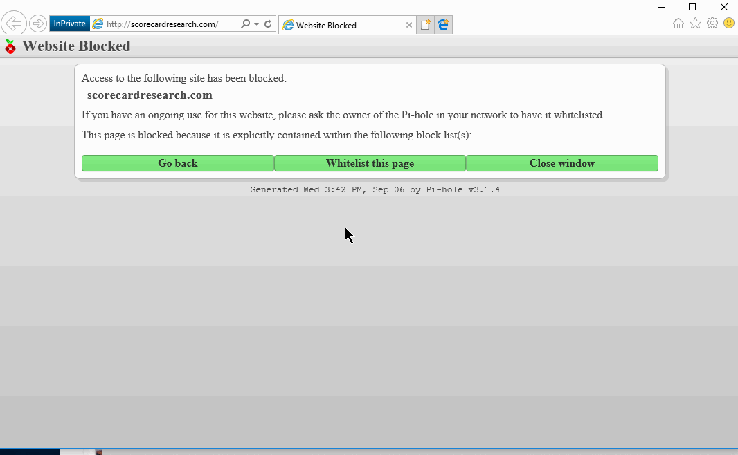

@n6vmo Sure, ads are blocked and it looks fine at first glance. But block-page and pixel server is rendered useless. You will likely see browser error or webpage not available if you go to for example http://scorecardresearch.com/ Normally it would load the block page
Also pixel blocking will be broken if you try "curl http://scorecardresearch.com/ads.jpg"
The Pi on the left is using port 80, while the Pi of the right is using port 8017. Not sure what pixel blocking is or its benefits.
My Pi' run headless, so I can't easily see what http://scorecardsearch.com displays.
If an ad gets replaced with a 404 page like the one on the right, you might see that page in place of the ad in the page. With the pixel blocking, the ad goes invisible.
