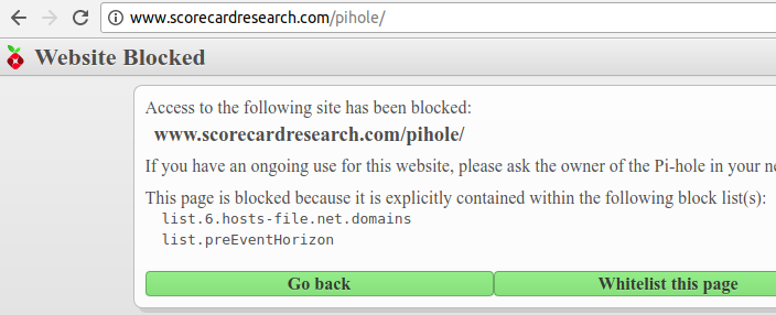

When I navigate directly to a blocked domain from a client, a block page (as seen in this post) should appear.
When I navigate to http://scorecardresearch.com/ as in the post above, I get redirected to the DocumentRoot for pihole (/var/www/html/).

Implementing _default_ option and removing 000-default.conf had no effect on the end result. Navigating directly to a blocked domain brought me back to my pihole document root /var/www/html.
Some additional information: If I navigate manually to /pihole/ after I've been redirected to the document root from a blocked domain, I see the block page (notice the URL):
If I try to navigate directly there via http://pi.hole/pihole/ I get a 404 page. it seems that navigation directly to /pihole/index.php is disallowed.
There is also some different behavior on my clients today. I must have changed something despite my intention not to: curl from clients OR server now receives the correct pixel image. At this point that might be "good enough" because pixel block seems to be working. Still confused why the direct block page is not being redirected properly but considering how rarely I expect that to happen, I think I can live with the current implementation.

It looks like you need to make sure that the 404 page on both IPs go to the block page.
I don't think the 192.168.1.210 address can point to a 404 page outside of the DocumentRoot, can it? pihole/index.php lives in /var/www/html, but that is a directory above the DocumentRoot for the virtual host at 192.168.1.210.
