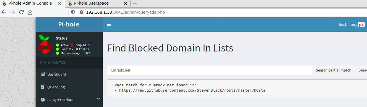

For example: r.mradx.net

As you can see, the domain is on the block list, but pi -hole resolves it.
