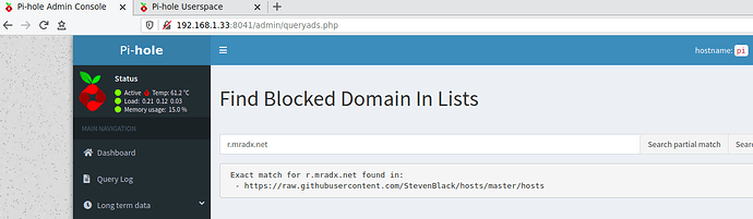

For example: r.mradx.net
# nslookup r.mradx.net
Server:    192.168.1.33
Address 1: 192.168.1.33 pi
Address 1: 2a00:1148:db00::28 r.mradx.net
Address 2: 217.69.139.244 r.mradx.net
As you can see, the domain is on the block list, but pi -hole resolves it.
192.168.1.33 is the RaspberryPi address with the pi-hole installed in it.
