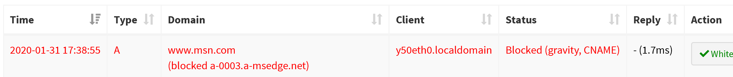

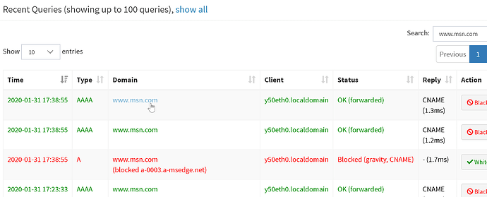

I just retrieved an update for the web interface, installed and cleared the cache.

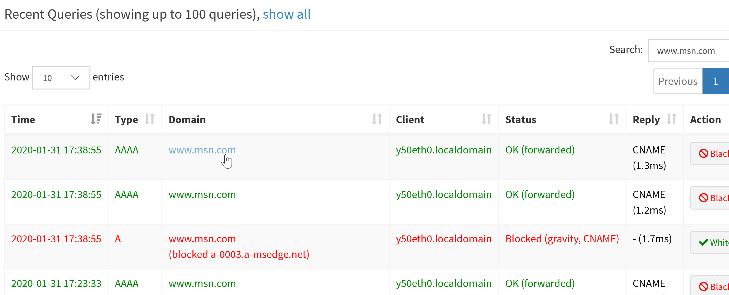

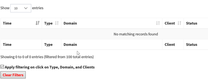

mouseover on the (blocked domain), tooltip says 'Click to show only queries with domain....'
When I click …

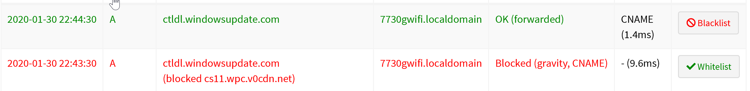

Also notice the blocked and allowed domain name are the same (this time both A entries)...
The best way to help us debug and add features would be to use a stock system, installed via our installer command, and starting fresh. If that shows issues then it's something for us to investigate. If you can not duplicate the situations with a known base that everyone can access then it's likely not an issue we can resolve.
Maybe because there is no match with the text you clicked. There is no domain that contains ' a.b.c (blocked x.y.z)'.
The domains are 'a.b.c' and 'x.y.z'.
Good assumption. I fixed this now.

This happens all the time, for www.msn.com, all I need to do is close Edge and reopen it -> bingo. Unfortunately, it's not the only domain that shows these queries. Yesterday (screenshot), was the only time I noticed both entries being A.

There is a filter option in the Query Log. If you use that to filter one domain you can see the (different) results of those queries.
I think that would not be simple to do in SQL. The results of a query have to parsed to compare results.
Query Log looks like an almost one to one representation of the database table so it takes less time to use Query Log.

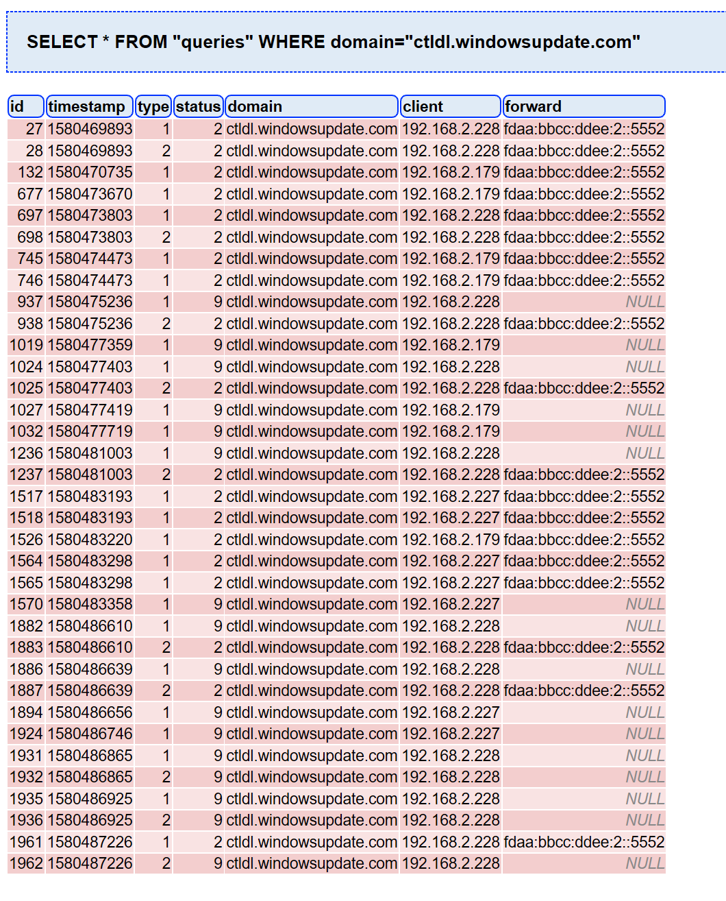

How I find them:
sql script:
.mode csv
.output /home/pi/cnames.csv
select * from queries where status=9;
.output stdout
.quit
run:
sqlite3 /etc/pihole/pihole-FTL.db < /home/pi/cnames.sql
now open the pihole web interface, select Long Term Data / Query Log, select Date Range today and enter the domain from the csv file, you want to check, in the search box.
The problems, if any will be visible immediately, since they should be either all red (blocked) OR all green (allowed)
If you want to check another domain, all you need to do is enter a new domain name in the search box, the page refreshes immediately, without any other actions.
I've deleted /etc/pihole/pihole-FTL.db and the logs, after stopping pihole_FTL. This will ensure I'll only see records, that have been logged while the debug query logging was active. Now, wait and hope for a problem to appear soon (www.msn.com is a sure hit for me - using Edge, but that log was already submitted)...
caught one, using the above method, make sure you read the entire post, something else I noticed, explained before the second screenshot..

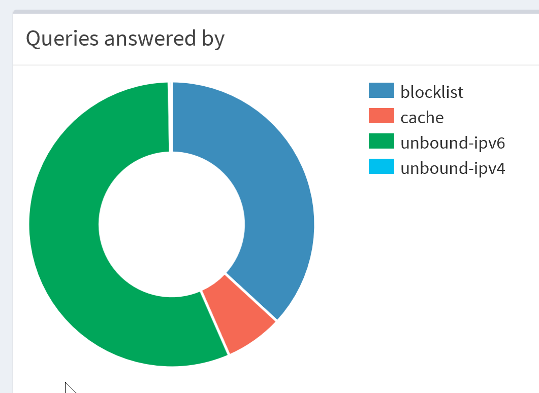

I'm using two forwarders in my pihole configuration:
server=127.10.10.2#5552
server=fdaa:bbcc:ddee:2::5552#5552
All the queries for this domain have been forwarded to the same unbound resolver (fdaa:bbcc:ddee:2::5552#5552 - see screenshot below), in fact, of all the queries performed since the restart this morning, 56.2% have been answered by the IPv6 resolver, 6.6% cached and 36.9% blocklist. Currently, pihole doesn't like the IPv4 (127.10.10.2#5552) resolver very much (slower).
Not related to this issue but you don't need to use IPv6 over a local connection to the same host. Just use the 127 address. You're over complicating a lot of things.
Didn't watch it since the patch. Never saw different results of same query.
Only saw difference between A and AAAA.
And clicking on blocked cname gives no matches.

DL6ER did release an update for the branch new/CNAME_inspection_details this morning, run pihole -up and don't forget to clear the browser cache. Since the update, clicking on the domain in the query log shows the relevant queries.
in the query log:
click on the domain:
I would really appreciate if you also list your configuration, and use my method to identify a recent occurrence of the problem we have been seeing. If NOT, I'm afraid the bug report will be closed without further investigation (independent source).

pihole checkout ftl new/CNAME_inspection_details
pihole checkout web new/CNAME_inspection_details
  Pi-hole version is v4.3.2-391-ge0b3405 (Latest: v4.3.2)
  AdminLTE version is v4.3.2-363-g90a09d1c (Latest: v4.3.2)
  FTL version is vDev-122a701 (Latest: v4.3.1)
Resolver configuration? unbound or other?
Please run the sql script and evaluate the results in the csv, really easy, doesn't take up to much of your time.
Unbound 1.9.4-2+b1
