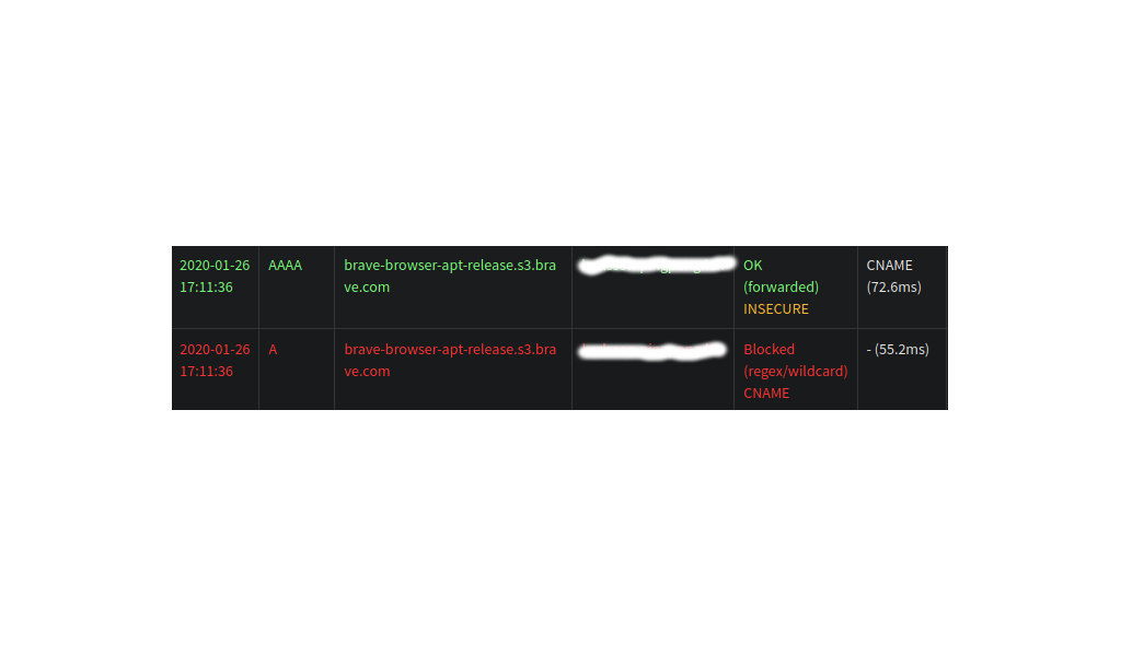

Can someone please explain what happens here? Is there a difference in blocking A and AAAA requests? That's the only difference I can see now.

Is this topic (Some domains are intermittently blocked even though they are on the whitelist) related?
Hmm, yes, maybe. Could you add the debugging options I put in there as well and check what the FTL log says for you when this happens again?

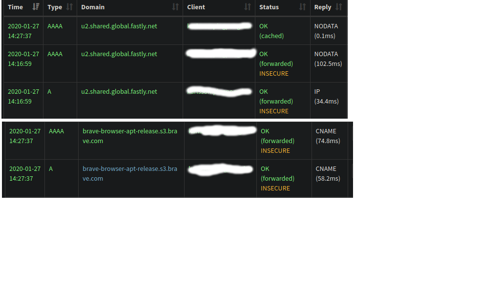

Still got the same situation as in the screenshot. To reproduce I did an apt-get update on the client hitting the Brave repository.
Debug Token
https://tricorder.pi-hole.net/59vdqa1s9h
When I put the CNAME domain (u2.shared.global.fastly.net) on the whitelist there is a different result. Did that at 14:16:43.
Edit: Removing CNAME from withelist again gives result as screenshot in first post.
@Arno We collected enough details in the other thread you referenced above to believe that it is really the same cause. It is a caching issue inside FTL where special whitelisting rules were not applied as they were meant to be. I proposed a fix which you could try with
pihole checkout ftl fix/deeply_whitelisted_domain
Any testing would be highly appreciated.

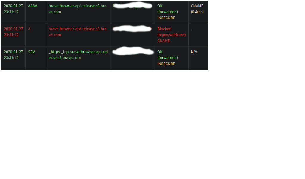

brave-browser-apt-release.s3.brave.com does not show up in Query log or pihole-FTL.log and isn't resolved on the client,
Are you sure the client is still using the Pi-hole as DNS server? Queries not appearing in the log should not be possible in any way.
Yes it does but now I also did sudo systemd-resolve --flush-caches on the client. Now it shows up in Query Log.
pihole -q brave-browser-apt-release.s3.brave.com
[i] No results found for brave-browser-apt-release.s3.brave.com within the block lists
u2.shared.global.fastly.net is still blocked.

Well if you blocked the CNAME domain, then brave-browser-apt-release.s3.brave.com should be blocked as well due to deep CNAME inspection unless you whitelist it specifically, no?
But yes, the difference between IPv4/IPv6 confuses me too (and I know that's the bug you're addressing), but I was confused on whether the intended behavior was that both the IPv4/IPv6 were supposed to be allowed or blocked. Unless I'm mistaken, if you blocked the CNAME domain then they should both be blocked, and the IPv6 request is incorrectly allowed?
If that's the case I was thinking it's actually sort of the opposite of my issue where a domain is erroneously allowed.
The IPv4 request is incorectly blocked imo.
Expected result for me with my configuration:
brave-browser-apt-release.s3.brave.com IPv4 and IPv6 allowed. (because it is not on any list)
u2.shared.global.fastly.net (next in chain) IPv4 and IPv6 blocked (as expected because it is blocked by regex. Fix, by design, is to whitelist domain)
