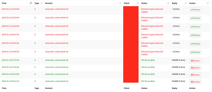

I've seen cases where even though a domain is explicitly on my whitelist, I see in the query log and on my devices when they try to access said domain that it is blocked due to deep CNAME inspection. The example I'll give is of "steamcdn-a.akamaihd.net". This domain was under a exact whitelist entry for the past 24 hours (i.e. from my understanding, for all the times in the screenshot, it should have been allowed, despite linking to a blocked CNAME). This doesn't even happen 100% of the time - sometimes the domain will be allowed and then a little while later it will be blocked again, as shown in the screenshot.
If I run "pihole restartdns" the domains seem to be correctly allowed for a little while.

I've found that after running the dig command on steamcdn-a.akamaihd.net.edgesuite.net (not explicitly whitelisted, so blocked because a1843.g1.akamai.net is blocked through regex), then steamcdn-a.akamaihd.net will be blocked 100% of the time (presumably until I restart the resolver).
Oh, this is a false-positive cache hit...I thought I had ruled out such scenarios, but apparently I haven't thought about all possible cases. A partially cached CNAME inspection stored as partial path is apparently able to slip the explicit whitelisting rules.
I will prepare a fix, many thanks for reporting and providing the necessary details!
