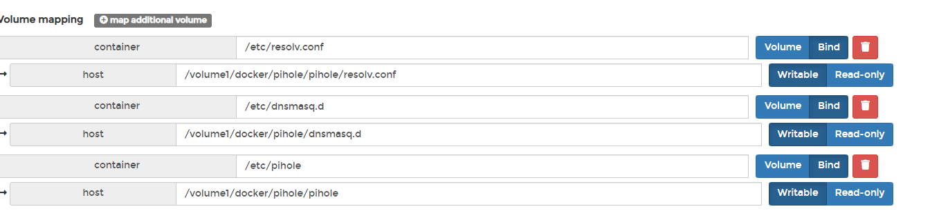

Relevant settings are screenshots below. That help?

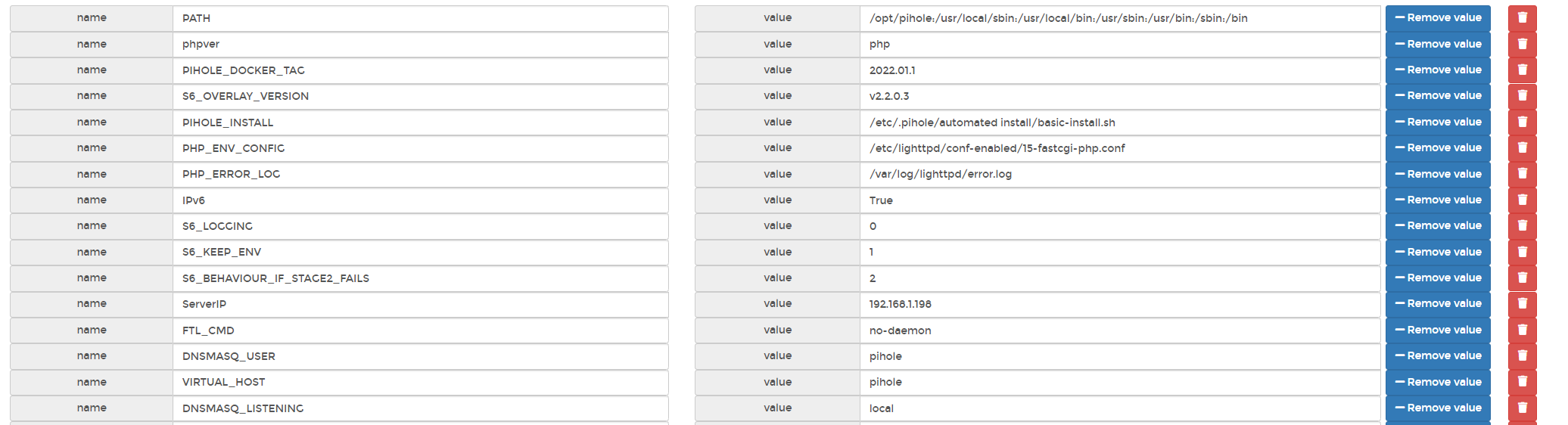

Since you run Docker via Portainer:
Portainer may hold on to environment values from previous containers even on container restart. If this would create issues for you, you'd have to manually remove offending environment variables.
See how this was resolved in Pihole Portainer/Docker 5.8.1 startup error?.
Tried this, but didnt work.

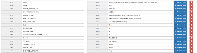

Your debug log still reports your Pi-hole Docker container as 2022.01.1.
That release tag would have comprised Pi-hole v5.8, FTL v5.13, Web Interface v5.10, but your debug log reveals those to match the current Pi-hole v5.10, FTL v5.15, Web Interface v5.12.
Please be more specific how you followed that solution suggestion:
Which variables did you actually clobber?

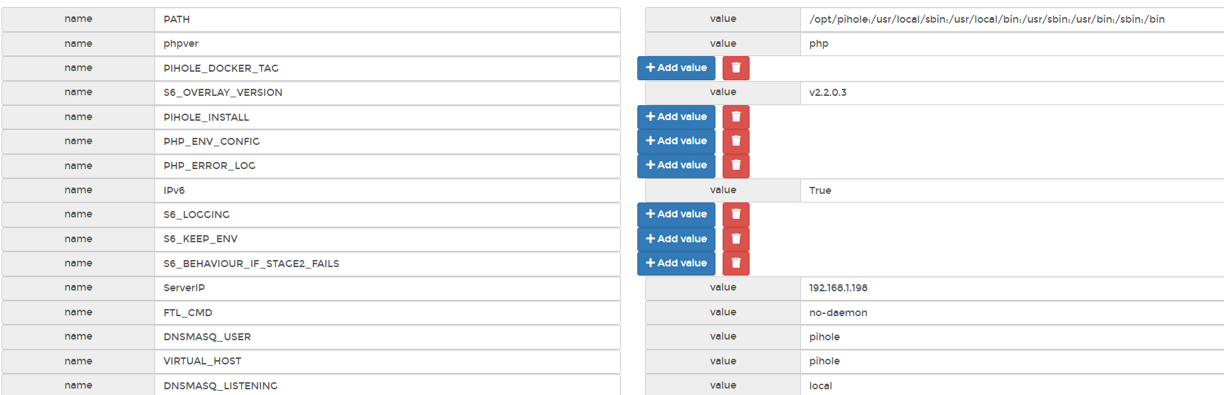

This shows what I deleted

It looks like you've only removed the values, not the variables themselves.
Also, did you recreate the container after deleting those values?
I'm not using Portainer myself - someone familiar with Portainer may be able to provide more specific advice, so it may be a good idea to mention Portainer in your topic's title.
No, I did remove the values. Just used above as visual cue to what I removed

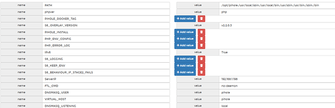

Sorry for being pedantic, but do you mean values here?
If so, try removing the variables and Recreate the container afterwards.
