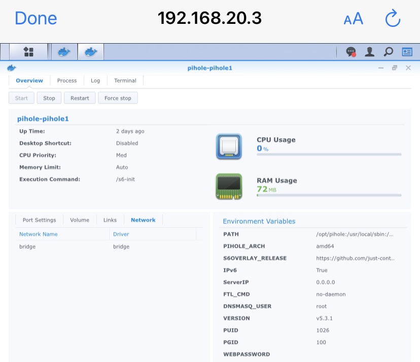

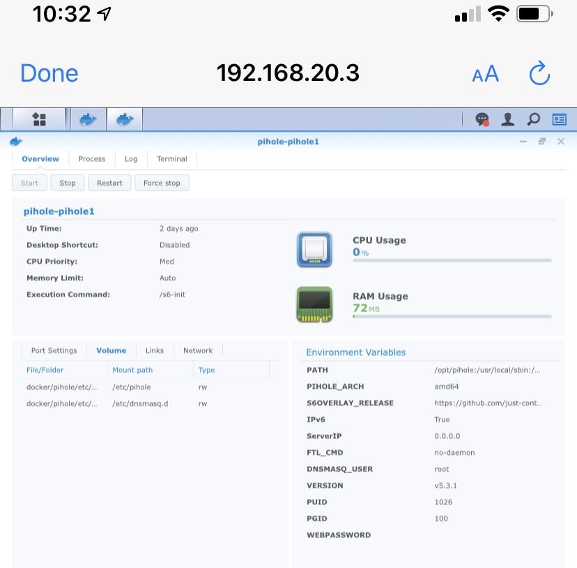

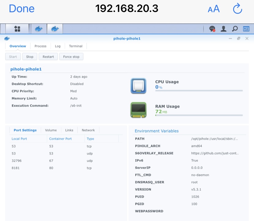

Here are my settings as viewed from the desktop mode Docker GUI from my phone.
