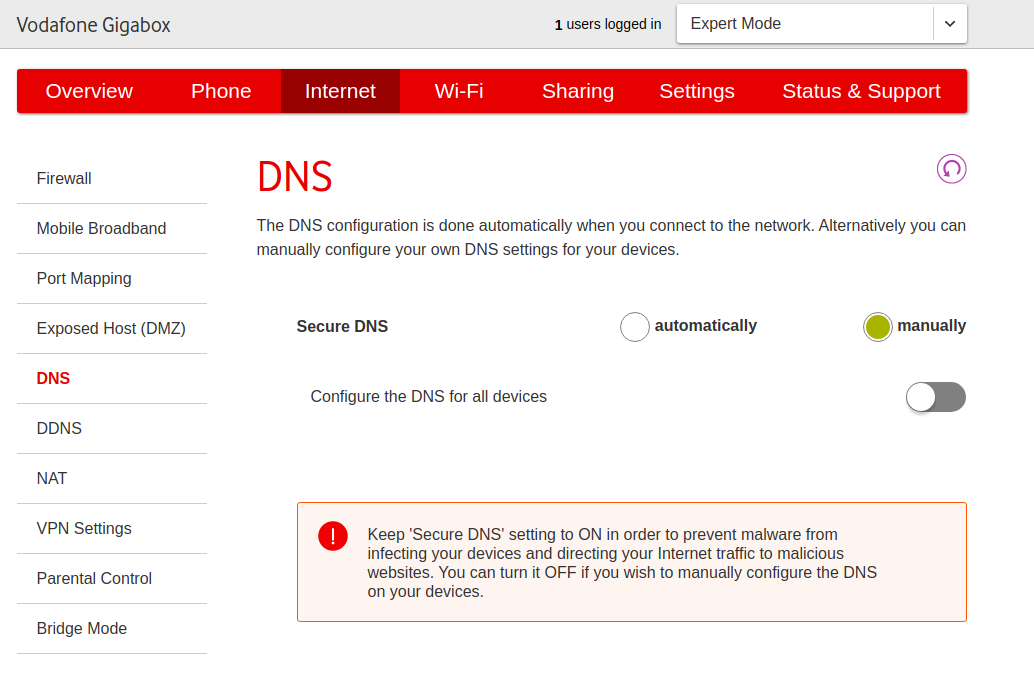

OK, got it working. I think the issue was me misinterpreting (bad UX?!) my Vodaphone gigabox router. Here is what I set.
  1. Disable DNS, and don't set the pi-hole IP as DNS server Just leave it empty. This seems to disable DNS completely.
  2. Set DHCP Server to disabled in the router, and turn on DHCP in the pi-hole for IP range 192.168.2-250.
