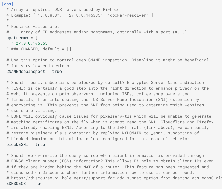

The documentation can be found directly in pihole.toml file:

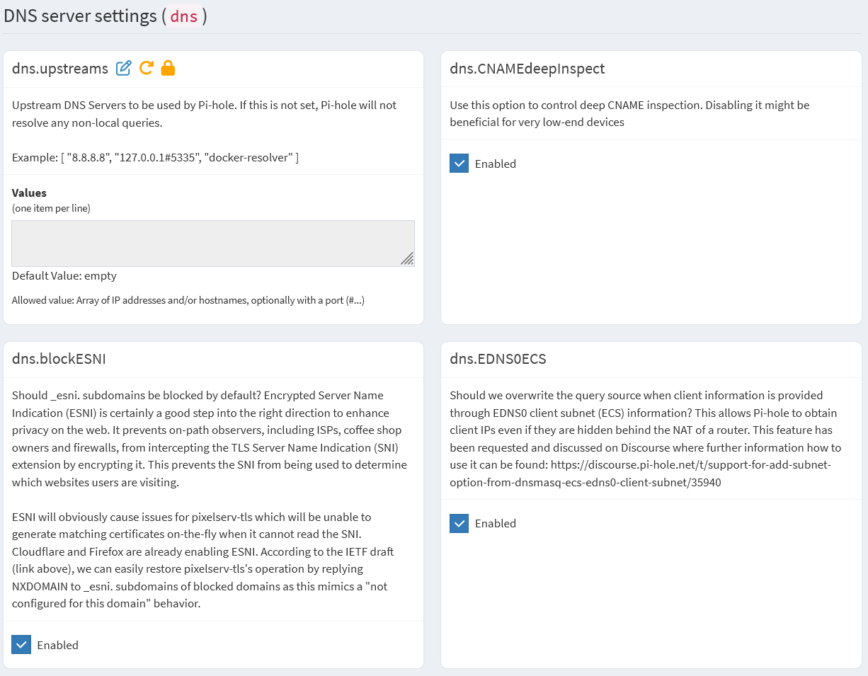

The same information can be found on the web interface Settings > All settings page:
