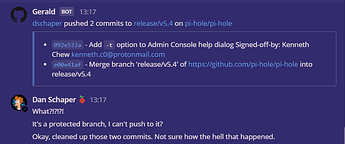

I think there was a glitch earlier today that pushed commits to that branch. That isn't supposed to be possible since the branch is protected.
There's an open PR that fixes a bug that should be pushed sometime in the next day that hopefully will bring things back in to sync.

Yeah, I didn't believe it either when I got the pop up from Mattermost that showed commits had been pushed to a protected branch.
As soon as that happened I went in and reset the head pointer to the original commit hard and removed the two additional commits from history. That required unprotecting the branch so I'm not really sure how the two stray commits were added in the first place.
Every action on our various repositories is logged and posted as messages on our Mattermost server so we can see everything that goes on.
Edit: I think the OP may have pulled the branch in the few minutes that the extra commits were on the branch. That would explain why this isn't being seen by most everyone else.
