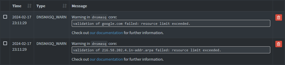

I got the repeatly warning of dnsmasq_warning, that "validation of google.com failed: resource limit exceeded."
How can i proceed?
Shall i ignore the message of DNSMASQ_core as only an DNSMASQ_warning or how can i adjust the resource limit, so the validation will be completed?
The linked documentation didn't give me any further hint how to proceed here.
A further started google search does not give me any relatable information.
Any simply deletion of this error/warning only leads to the warning periodically reappearing in the pihole admin panel (backend).

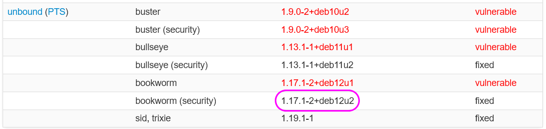

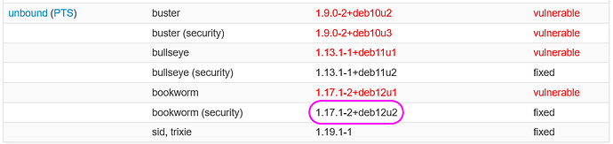

For what it's worth, it doesn't look like an unbound through version 1.19.1 is available for RaspOS on Rpi5 and apt currently only updates through unbound/stable-security,now 1.17.1-2+deb12u2 arm64.
According to these Debian pages, version 1.17.1-2+deb12u2 has been fixed:
Thank you. That makes sense. The update to the current version was this week.

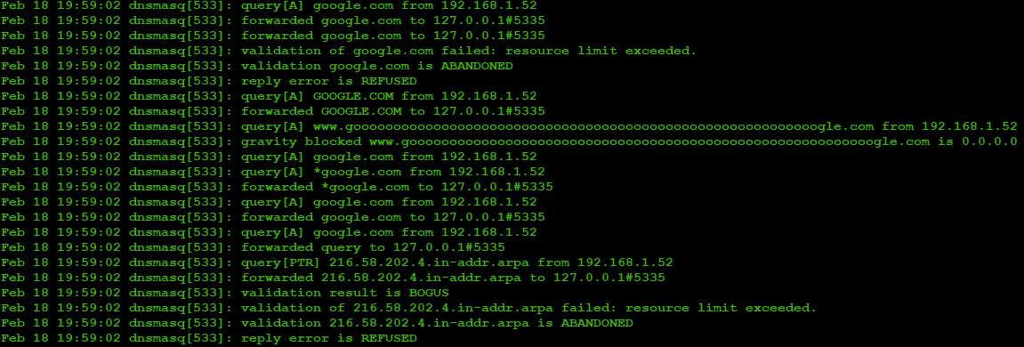

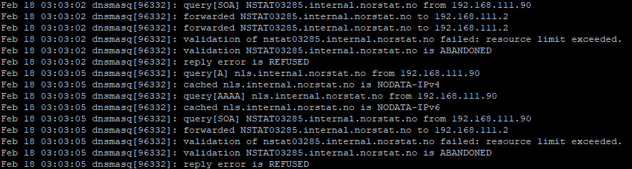

I am also repeatedly receiving this warning since upgrading to FTL 5.25, but it's for a different URL (it appears to be a URL associated with my wife's employer). If there is any diagnostic information which may be of help, I'll be happy to provide.
Thanks,
Keith
Thanks for your further information. Even though I haven't had mich time today, I just took a quick look at the the changes that have been merged into dnsmasq 2.90 last week and found at least one other path through which this warning might be logged incorrectly: If the upstream server replied with REFUSED.
Please check your /var/log/pihole/pihole.log at the timestamp the warning was triggered for the mentioned domain. What are the related log lines?
You should be able to find them quickly using
grep -C 20 "resource limit" /var/log/pihole/pihole.log
Notes: If there was a lot of activity going on, 20 may not be enough. If the event was yesterday, you may need to append .1 to the filename.
I've ran the above command, which did reveal a REFUSED response...
