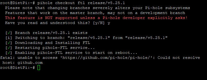

Hello DL6ER
with your latest pihole checkout command, i only get an error.
Now it works :slight_smile:
It seems your Pi-hole didn't have Internet access at that time - or name resolution was unavailable by other means. Your error message clearly states that this was a local problem.
