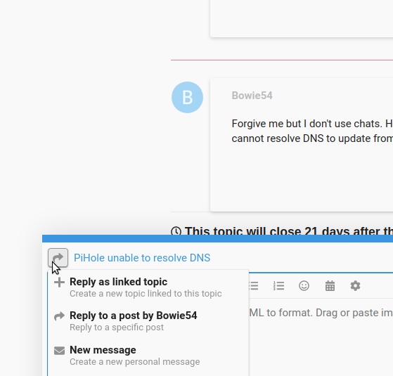

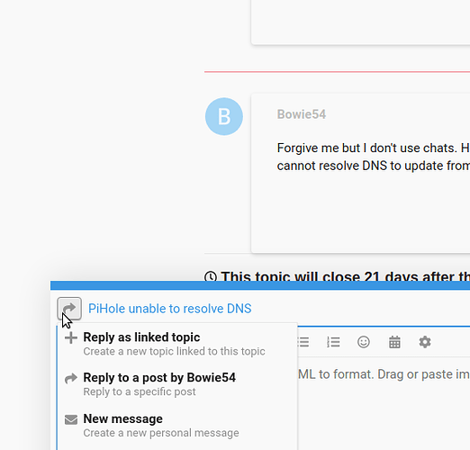

Forgive me but I don't use chats. How can I DM you the debug log. Also I tried to update Pi-hole, but it cannot resolve DNS to update from install.pi-hole.net.
It's personal message.
When I try and post the debug to you, I get this error message on the chat.
Sorry, new users can't mention other users.
Sorry, new users can only put 5 links in a post.
I'm only copy/paste the output from the debug. Nothing else.
Paste it in as "preformatted text". Links won't count within.
Now it says I cannot send a personal message to you
Just post it here, I'll hide it afterwards.
