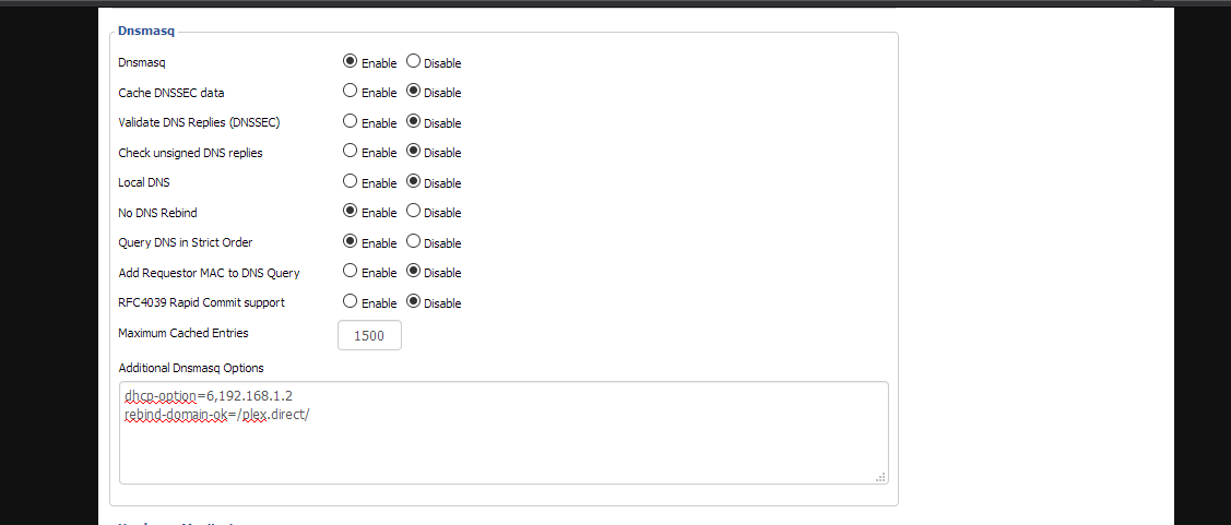

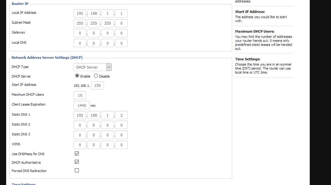

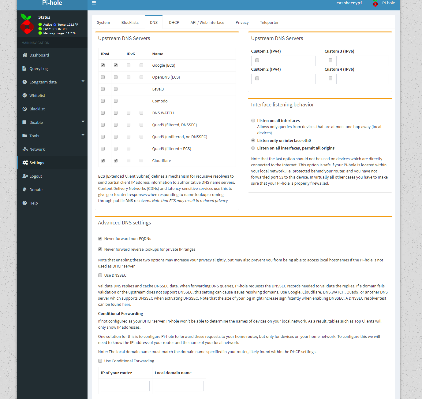

I also do not have conditional forwarding set in my pihole settings, which lot of other threads seem to mention. I also do not use DHCP with the pihole either. I use ddwrt to hand out IP Leases in the Services tab.
Here are my router settings:
Here are my pi settings:

These are queries that have always happened on the network. We previously didn't report them and only reported A/AAAA queries. We now report them as they are queries that Pi-hole is seeing, and knowing that they are happening is something that we feel is important. So the options become either ignoring them and going back to A/AAAA only reporting (leaving the underlying situation really unchanged and the PTR queries still occurring but not reported) or fixing the issue that is causing the PTR records to be queried and find out what application is not behaving as you would like. (Really it should be caching the response and not blasting out queries repeatedly.)
Well, I just confirmed which application was responsible. And looks like rebooting said application fixed it. Guess router change scared it or something.
