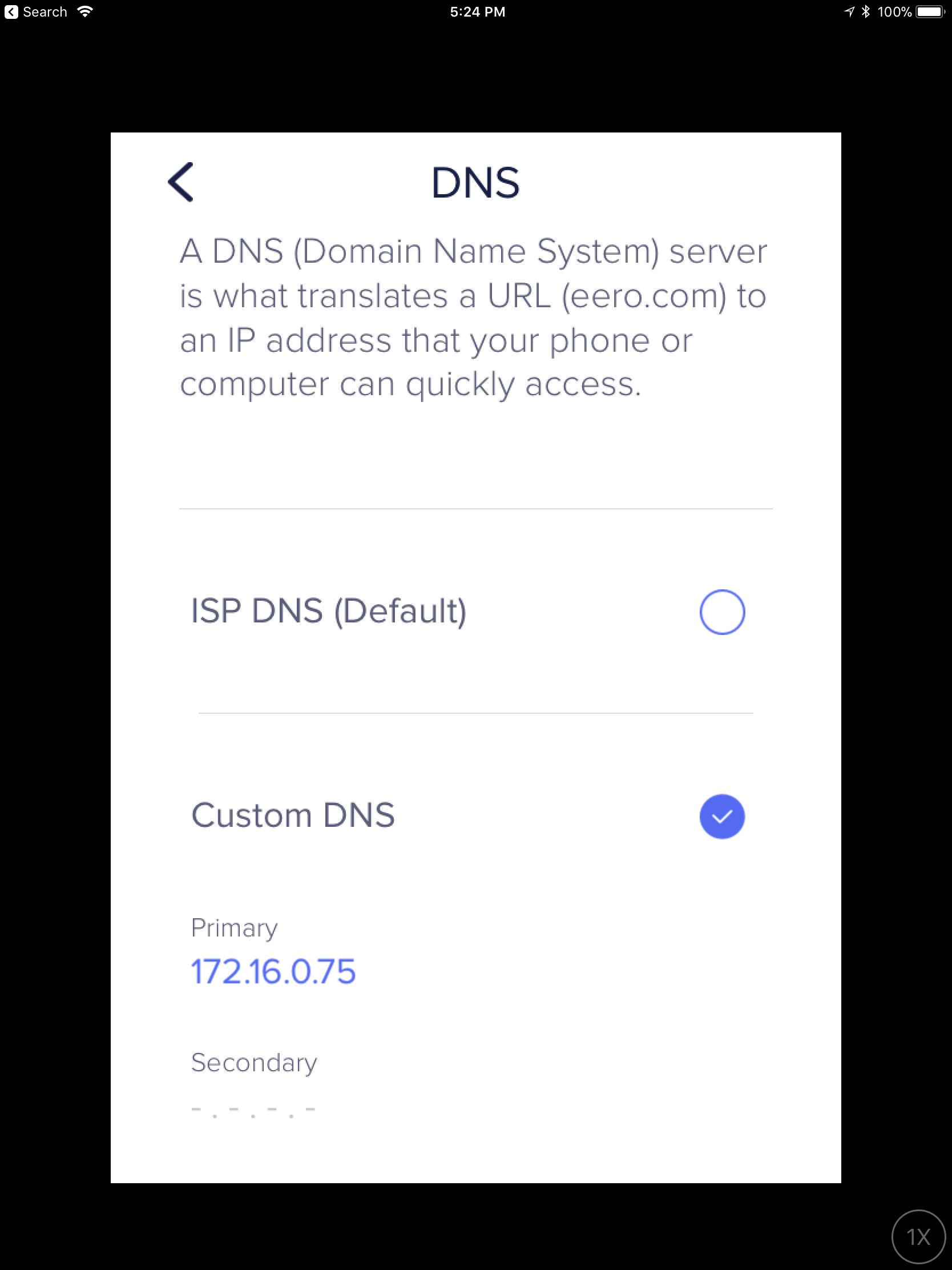

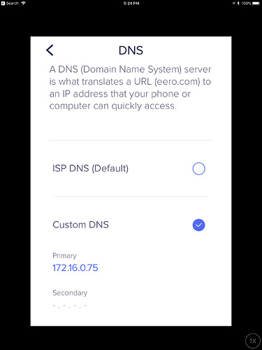

My router is pointing to my pihole machine for DNS, and yes, it’s the only DNS server listed. Although when it was working previously, it pointed to both pihole and 8.8.4.4
I confirmed clients are only using pihole for dns.

You probably configured the WAN DNS part of the router to point to the Pi-hole IP.
Do you have a screenshot ?
Proper way is to push the Pi-hole IP address as a DNS server to its clients through the DHCP service on the router or use Pi-hole's DHCP service.
