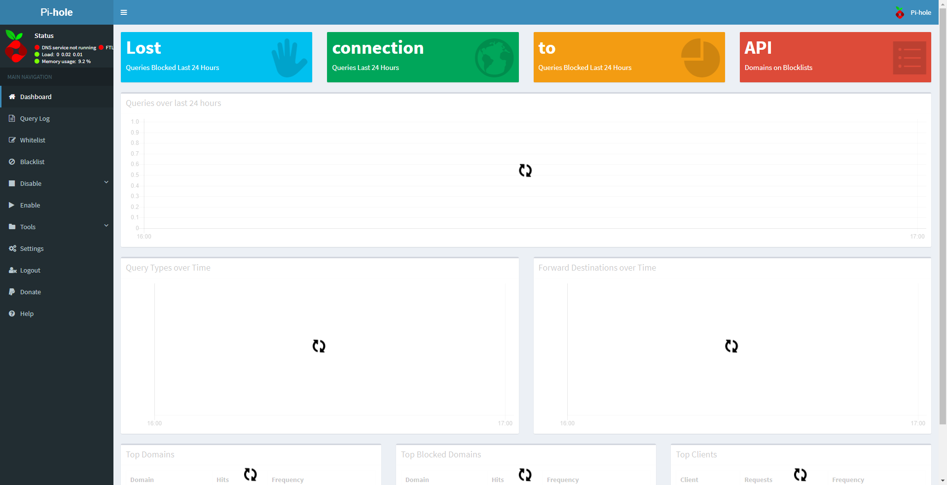

i updated my pi hole installation and once again it broke it (i used pihole -up) its installed on raspbian

Does you webui page work?
Run
sudo service pihole-FTL status
and let me know if it is running.
Loaded: loaded (/etc/init.d/pihole-FTL)
Active: inactive (dead)
when i installed the update it said something like dns service failed to start contact support or something. however since i made a restart after that i dont have the console output anymore
