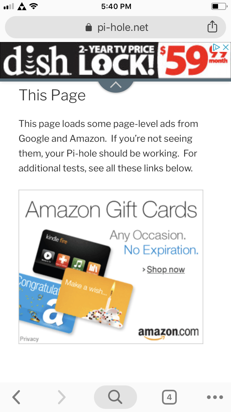

Yes give me a moment on the screen shots.The reason I have determined it is not blocking ads,is because it only blocks ads on the pi itself, If I pick up my laptop,watch on my roku,or use my iphone ads come in same as if pihole was off. When I set my pihole up as the only dns server in my rotuer shortly there after I lost the ability to make successful connections to webpages or services. Yes I routinely make remote access to my vnc server.

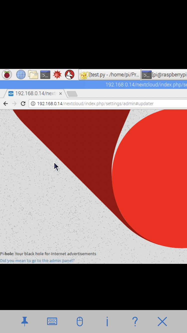

That is supposed to be my updater for my nextcloud and somehow it’s just a giant pihole logo with redirect to the admin page at the bottom

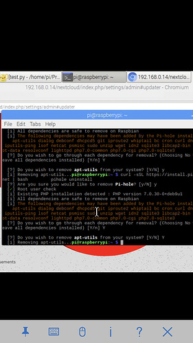

This is what happens when I try to uninstall pihole. It goes through apt-utils then stops and acts like nothing changed. I’ve always had to reinstall raspbian if I wanted to remove pihole
You can manually remove Pi-hole with :
sudo rm -rf /etc/.pihole /etc/pihole /opt/pihole /usr/bin/pihole-FTL /usr/local/bin/pihole /var/www/html/pihole /var/www/html/admin
I think one of your existing software that required http (apache from what I can see) might have got tangled with lighttpd and that's where the whole bad web interface experience originates from.
Apache seems to be running on port 81 where as lighttpd is on port 80.
This request:
went on port 80 and it hit lighttpd.
I think that path is availabe under apache.
Try it with http://192.168.0.14:81/nextcloud

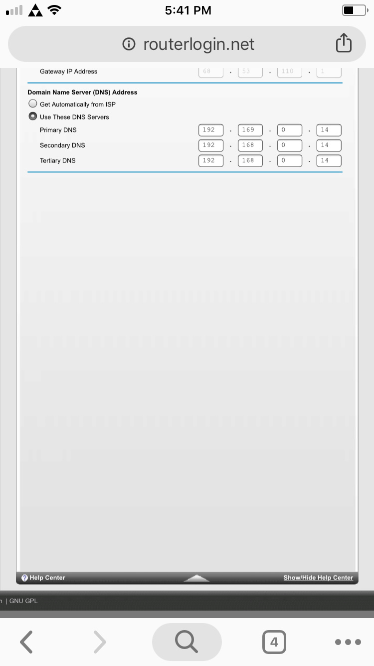

This indicates that the Pi-Hole is not receiving DNS requests from these devices and is not blocking any of their requested domains. With a second DNS in your router, clients will use that and bypass the Pi-Hole for some or all DNS requests.

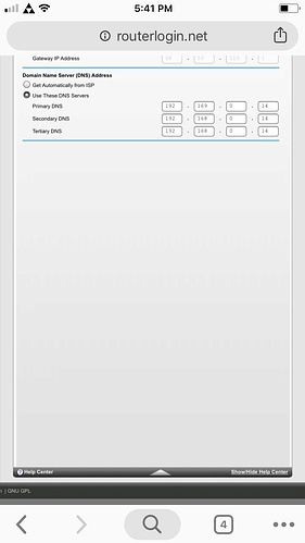

that?JFB here is what happens with my netgear router and configuring its DNS. I have tried entering just
primary dns as the pi and every dns as the pi nowhere does it allow me to enter the /24 at the end of the address does this matter?I note that when I do this I lose internet on the pi and my vnc server. I have also tried entering on the devices themselves but ads come through anyway. Is another dns snuck in here somehow?
here is my router setup
