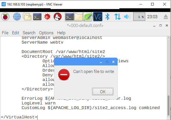

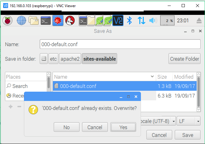

where can I change this script?
how to overwrite the file?
It will show this error
You need to launch the editor with sudo.
Something like sudo gedit or what ever your editor is. Looks like Leafpad possibly.

I cant edit 000-default.conf file
pi@raspberrypi:/etc/apache2/sites-available $ cd 000-default.conf
-bash: cd: 000-default.conf: Not a directory
