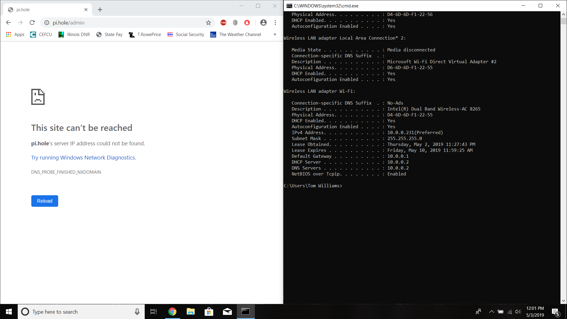

I do have DHCP turned off on my router, which is a netgear nighthawk x4s R7800, I do have DHCP turned on in pihole. I can't find anything on my router that would keep my wireless devices from using it. I can ping it just fine from wireless devices but when I do a nslookup, it can't pull the name of the pihole, but it shows the IP address of website and the IP address of pihole

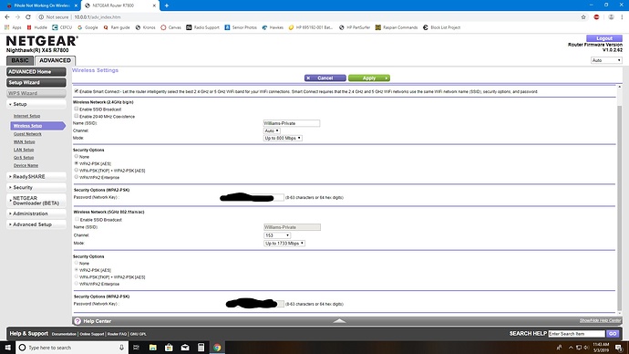

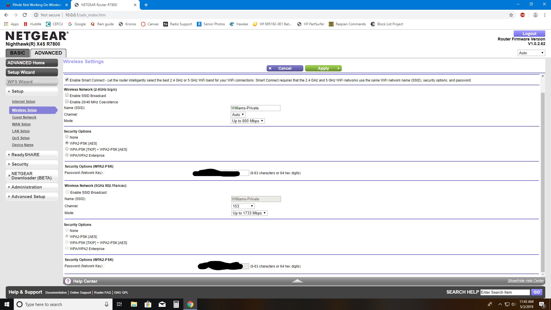

Would you happen to know what setting on this router is separating pihole from wireless devices?
Look in the wireless settings, and give the 2.4GHz and 5GHz bands the same SSID and password. On that router, there may be an option to combine them - if so do that.
I already have it set that way.
also, the the only way i can access it from wireless is if I type the IP address of it.
If I do it on a wired, i can type http://pi.hole/admin or the IP address
I'm not sure if this would help but 10.0.0.2 is my pihole

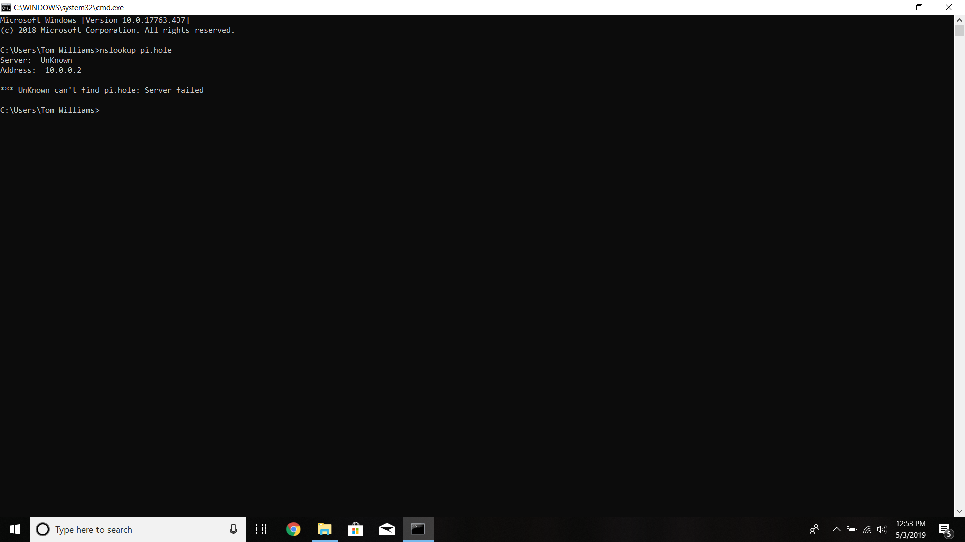

This is because the wireless clients are not using the Pi-Hole for DNS. From one of those wireless clients, what is the output of nslookup pi.hole

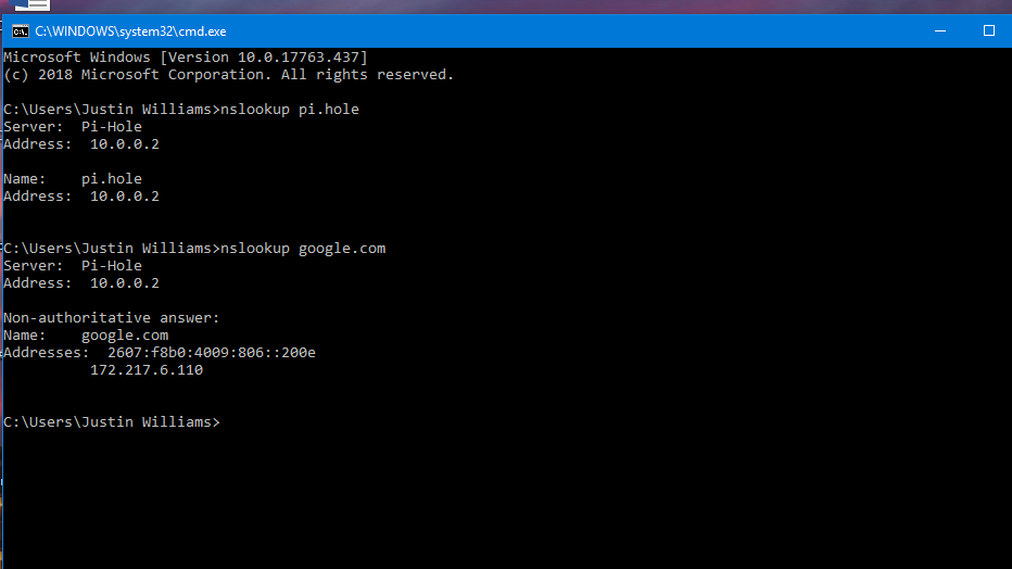

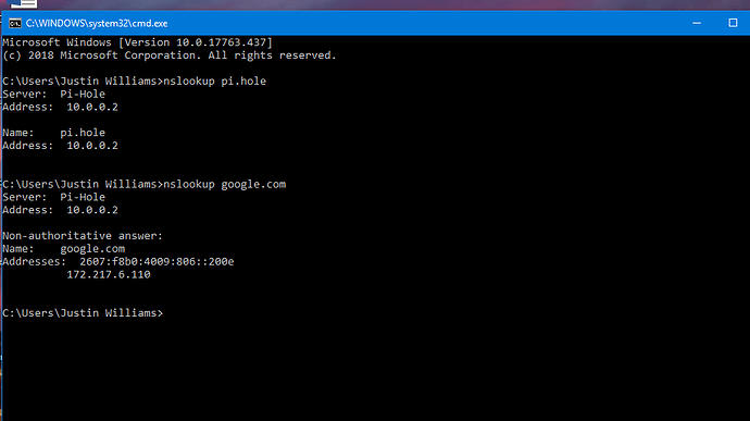

10.0.0.2 is pihole
here is from a wired connection if it helps.
it still does not block ads on wireless devices
