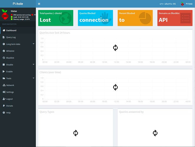

PiHole not working after upgrading Ubuntu Server from 18.04 to 20.04
Fully working PiHole setup
I have tried to do the following with no success:
  • run 'pihole -r' to repair the setup
  • uninstall with 'pihole uninstall' and reinstall

Ubuntu 20 is not a supported OS and you will need to do some workarounds to get it to work with Pi-hole.
https://www.reddit.com/r/pihole/comments/g86xo8/after_ubuntu_2004_upgrade_unable_to_start_dns/
Thank you again.
I did a 'sudo rm /etc/dnsmasq.d/lxd' as suggested in the Reddit post and also 'pihole -r'.
Now everything works just fine.
