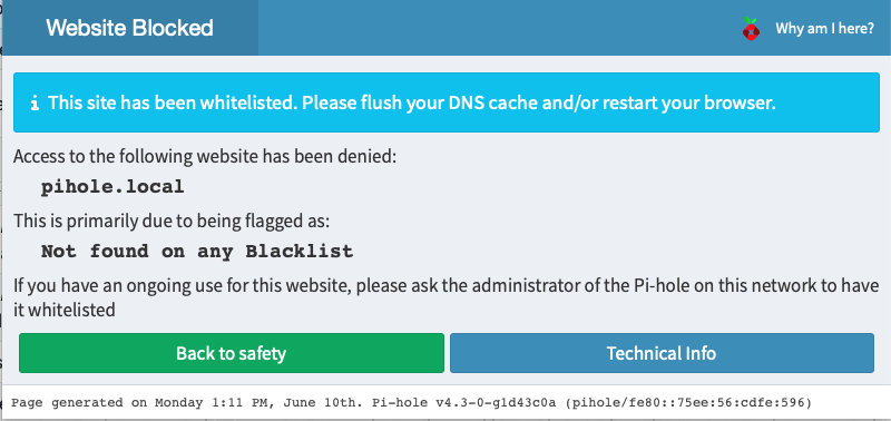

pihole.local blocked because is NOT found on any blacklist?
#1
It seems pi-hole disrupts mDNS/Bonjour/Avahi queries in Safari and Chrome on macOS.
Pi-hole Version v4.3 Web Interface Version v4.3 FTL Version v4.3.1
I expected to be able to visit http://pihole.local in the browser.
When I try to visit it using Safari or Chrome on macOS, I get the “Not found on any Blacklist” reason for why a website is blocked. This makes absolutely NO sense to me. Why would it block something because it’s NOT found on a blacklist? Moreover, as you can see in the screenshot, it’s expressly whitelisted (I did this the first time I got the message), but it still doesn’t go through.
I’ve restarted Safari and run through every macOS DNS cache flush I can think of (sudo killall -HUP mDNSResponder;sudo killall mDNSResponderHelper;sudo dscacheutil -flushcache).
https://tricorder.pi-hole.net/t171n9ofpy
Not Found On Any Blacklist

I understand redirects and 404. I guess I’d argue that the Pi-Hole 404 is very confusing for several reasons, not the least of which is that it says (paraphrasing) “You were blocked because that address is whitelisted and not on any blacklists.”
I’d argue that Pi-Hole should probably understand its Avahi name and handle that the same as pi.hole.
At the very least, it should send all unknown traffic to the home page or the admin page, as it does with <ip address>.

Per the argue/countering here, I’d like to throw my hat in the ring real quick. I got linked here by my similar issue Not Found On Any Blacklist
In my case I’m using an AD domain which has its own DNS servers, and I’m using a format of pihole.domain.local rather than pihole.local. Although to @DanSchaper’s point I wouldn’t expect PiHole to know what to do with any .local address, I did tell PiHole to forward those requests to my AD DC/DNS servers, and they know exactly what to do with .local addresses (so long as they are my AD domain). To @JetForMe’s point, I also would expect that any URL linked by an A record to an IP would return the same result in my browser as entering the straight IP. Which means that because when I go to http://###.###.###.###/ I see the PiHole logo :vortex: and text telling me what I found and the link to the admin page, I would expect that exact same page to pop up when I go to http://pihole.domain.local/, presuming that my AD DNS returns an A record with that IP for pihole in domain.local. I agree that returning a valid page for all unknown addresses is not ‘good’, but in this case my existing DNS said it’s not an unknown address. I don’t expect PiHole to know what to do with an address it isn’t configured for, but I do expect it to return the same as what it would return for the IP, instead of “this page blocked because it’s not configured to be blocked”. At the very least, it’s an error message which could be improved.
Ultimately, I can also use http://pi.hole/, which is IMO a functional workaround but not optimal in an environment where everything else uses naming conventions like http://web1.domain.local/ and http://mail1.domain.local/, and we’d really prefer to use http://pihole.domain.local/ for consistency’s sake. So +1 for passing that request onto the external LAN DNS instead of returning a wonkey error message, but if it’s an insurmountable thing to fix, it’s not a huge thing to ‘suffer’ with. Overall PiHole is an amazing tool and I’m glad it exists. :woohoo:
