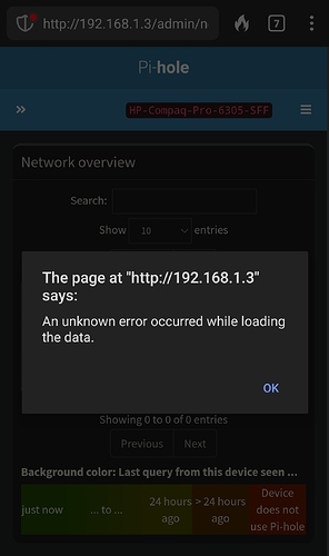

The issue I am facing: I have recently setup a pihole and i am facing issues such as not having any received queries even after setting up my router to specifically use the dns and having the dns request refused when trying to receive a request from outside the network (;; ->>HEADER<<- opcode: QUERY, status: REFUSED, id: 12350). One other issue i had is the sql database in which i dont really know why its spitting out errors on the log.
What I have changed since installing Pi-hole: nothing other than installing unbound
Debug token: https://tricorder.pi-hole.net/wBOHo4lx/

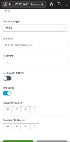

Here's the DNS setting on my router.
jfb
October 30, 2023, 5:37pm
10
At least from the client you checked, that client is using Pi-hole for DNS (via the router). The answers to the queries are correct. This would indicate that Pi-hole is working correctly, and clients that are getting DHCP from the router are using Pi-hole (at least this client is).

Okay good news I fixed the issue. It was my router
It didn't like that I put the same IP as secondary but now I discovered another issue

May have to do with permissions in the database or something
jfb
October 30, 2023, 6:32pm
17
Run these commands to move the existing query database to a new file name and create a fresh query database.
sudo service pihole-FTL stop
sudo mv /etc/pihole/pihole-FTL.db /etc/pihole/pihole-FTL-old.db
sudo service pihole-FTL start
