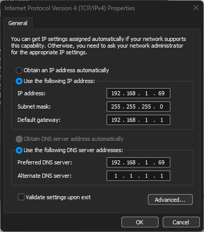

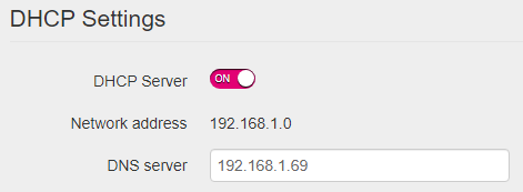

Did you configure your router or devices to use Pi-hole?
Reference:
My router is provided by my isp so I only have one setting for DNS. I did change that during the install.
I also set it up in Windows like so:
I think that's correct, at least I hope so.
How did you start your container?
Please, post the compose file or docker run command used to start it.
I used the example from the guide and edited the parameters.
Here it is:
docker run --name=pihole -e TZ=Europe/Budapest -e WEBPASSWORD=secret -e SERVERIP=192.168.1.69 -v pihole_app:/etc/pihole -v dns_config:/etc/dnsmasq.d -p 81:80 -p 53:53/tcp -p 53:53/udp --restart=unless-stopped pihole/pihole
lose that alternate DNS server!!!
Removed it but seems like it's still not working. :slightly_frowning_face:

I'm late to the party but I had the same issue when using Chrome. Default Chrome settings bypass pi-hole because secure DNS is enabled. Disable secure DNS in Chrome. Secure DNS may be enabled in other places as well. Android for instance may be using it.

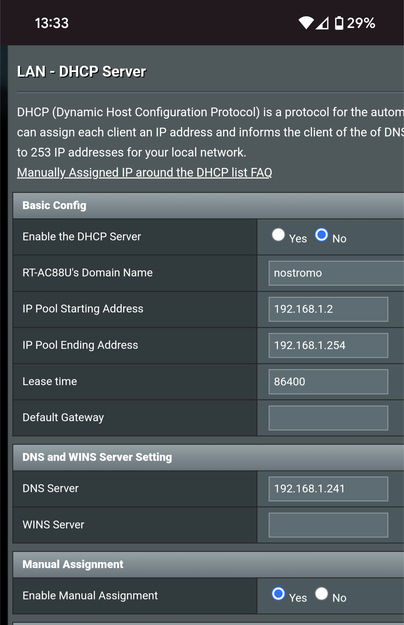

I'm really late to the party but I noticed in your router screenshot. Your router DHCP server appears set to ON.
This needs to be OFF. By being set to ON it means your router is acting as the DHCP instead of the Pihole. At least, this is how it works on Pihole with Raspberry Pi. I assume it should operate the same in a docker instance like a virtual machine. The Pihole becomes the defacto DHCP and assigns the local IP and this how it performs the block of spam to the LAN addresses.
For example here is my router settings
