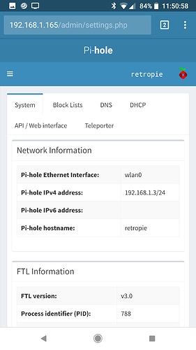

PiHole should only have 1 IP address and only be accessable from 1 IP
PiHole has 2 IP's 192.168.1.3 and 192.168.1.165

It's just a retropie image with PiHole running in the background over WiFi... I have DHCP disabled in my router and DHCP enabled on the PiHole
Can you post the output from ip addr and we can see if there's anything on that interface?
Here you go. Also seeing a few ipv6 addresses that aren't needed anymore possibly.
