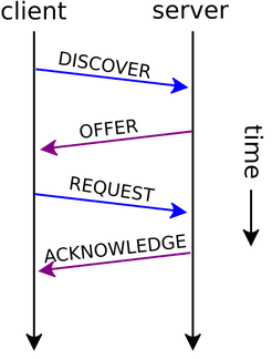

A complete, successful DHCP negotiation sequence would have DHCPDISCOVER (client), DHCPOFFER (server), DHCPREQUEST (client), DHCPACK (server). Note that the procedure for a client renewing an existing lease about to expire would be shorter, starting with DHCPREQUEST.
Your logs demonstrate that Pi-hole has correctly reacted to a client's DHCPDISCOVER with a DHCPOFFER, but the client fails to request the lease.
This could suggest that Pi-hole's offer was not received by the client, or that the client is discarding the offer, and silently so.
Some devices would be looking for some vendor-specific options in the DHCP offer - however, that kind of behaviour is usually tied to same-manufacturer devices, so I'd consider both your Wifi extender as well as Pi-hole unlikely to provide those. i.e. the respective devices should never have worked at all.
If the client were to reject the offered IP because it thinks that IP is already in use by some other machine, then it should NAK the offer, not silently discard it and broadcast a new discover.
