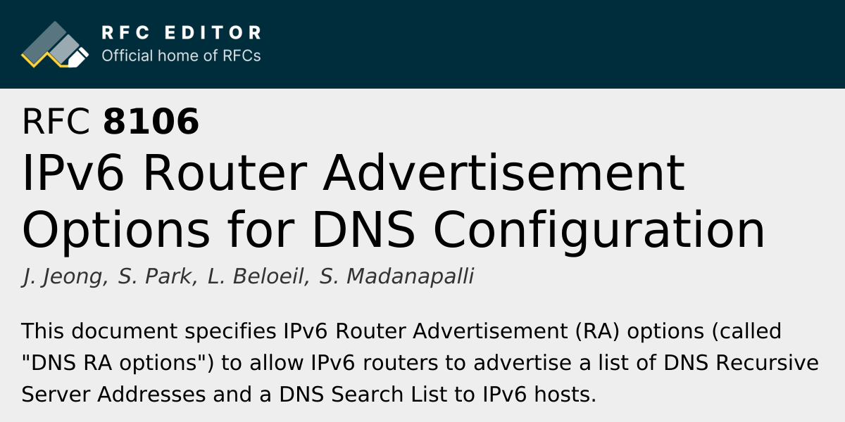

But as pointed out by @nite_route already, it appears your router is most likely advertising its own IPv6 address to the clients for DNS via something thats called IPv6 RA:
Which explains why no IPv6 queries are reaching Pi-hole bc they all go to the router IPv6 address instead.
If you are running Pi-hole bare-metal (not in Docker), you can see what DNS server(s) is/are advertised via IPv6 RA if run below one:
sudo pihole-FTL dhcp-discover
Look for a line that says "Recursive DNS server" (RDNSS).
Dont post unredacted output for above one here for privacy!
Some examples for configuring IPv6 RA RDNSS in the docs --> "Router setup":
